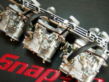

mossy Posted April 11, 2010 Posted April 11, 2010 I'm looking at getting some tripples for my L24 240z but I'm unsure what to get, brand and size wise, I found these and they look pretty tasty. Quote
NZeder Posted April 11, 2010 Posted April 11, 2010 First FET manifold = Good Second Those are Solex/Mikuni's made for Toyota only parts are different to the normal Mikuni PHH carbs they are known as the Type-S-5 and are 40mm carb. If I was looking for Mikuni's I would look for 3 x N44PHH with the 5 screws on top aka Type 4 (and one day I will get some when I start looking ) Quote
chris240 Posted April 11, 2010 Posted April 11, 2010 Mossy, thanks for posting the pic, Ive got the prized FET manifold (waiting to go on) but thats the first time Ive seen a pic of one all bolted up.. Quote
mossy Posted April 11, 2010 Author Posted April 11, 2010 Yeah the FET looks nice doesn't it, I was pretty keen on buying these but was unsure if they'd work on the Z even though the seller pulled them off his Z but there sold now anyway Quote
