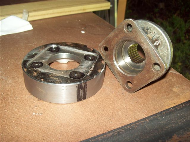

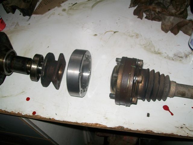

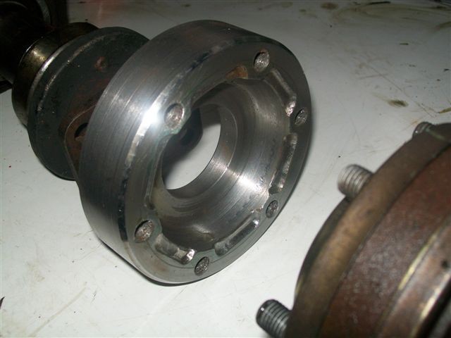

PeterAllen Posted February 19, 2010 Posted February 19, 2010 These are the OUTER couplings I've made for a Holden CV and axle (I'm using a Holden diff). If the output flange from the diff is the same four bolt patten then I can't see why you couldn't use four of them with Holden CVs. The problem might be the cost of having new axles made. The quotations I've had so far are between $200-$400 each. Quote
