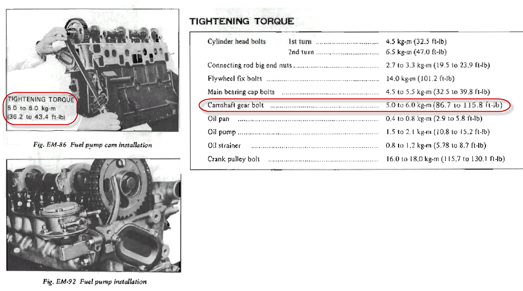

NZeder Posted February 28, 2010 Posted February 28, 2010 the carbs and fuel pump are out of my L24 and yes the items were working on my L24 before i put them on the L28. the mechanical pump has been fitted at the front near the cam gear. so i need to get that cup washer from the L24 and put it in the L28? hmm my bad I assumed you would have installed the cup washer/drive for the fuel pump. Yes that will be your problem you need that Assume = makes and Ass-U-Me or makes an ass out of u and me lol Also if you have a haynes manual becareful as one of them (can't recall if it is the 240/260z or the 280zx manuals) has the wrong torque setting for the cam nut. Also make sure the came gear and chain stay put - last thing you need to to have them come off and you pop the chain tensor = front cover has to come off to fix that. It is not likely to happen as you need to really pull of it to get them to come off the dowl etc. However you have your L24 to remove the cup from first so that will give you an idea of what you are in for. If you have a haynes manual just follow that - but just make sure you torque up the cam nut to the correct setting - I will look this up for you now too....will re post soon. Quote
OZ001 Posted February 28, 2010 Author Posted February 28, 2010 hmm my bad I assumed you would have installed the cup washer/drive for the fuel pump. Yes that will be your problem you need that Assume = makes and Ass-U-Me or makes an ass out of u and me lol Also if you have a haynes manual becareful as one of them (can't recall if it is the 240/260z or the 280zx manuals) has the wrong torque setting for the cam nut. Also make sure the came gear and chain stay put - last thing you need to to have them come off and you pop the chain tensor = front cover has to come off to fix that. It is not likely to happen as you need to really pull of it to get them to come off the dowl etc. However you have your L24 to remove the cup from first so that will give you an idea of what you are in for. If you have a haynes manual just follow that - but just make sure you torque up the cam nut to the correct setting - I will look this up for you now too....will re post soon. thanks.. but alittle walkthrough on how to do this as i dont want to stuff things up :-[ :-[ Quote
NZeder Posted February 28, 2010 Posted February 28, 2010 Ok I see that even Nissan have 2 torque setting in the factory service manual for the cam nut so I assume this why the Haynes manual do too. Anyway both time they have the metric torque setting the same so it is only the ft/lb that are different so checking a conversion tool I get 5-6kg is 36-43ft-lb which is wrong as the cam bolt should be around 100ft-lb - I have also attached a copy of the L28 torque settings. also download this PDF which is the FSM for the L20A/L24 this will have the step by step you are looking for - there are other FSM you can download from there too. http://www.xenons30.com/files/FSM%20L20aL24engine.pdf Quote
