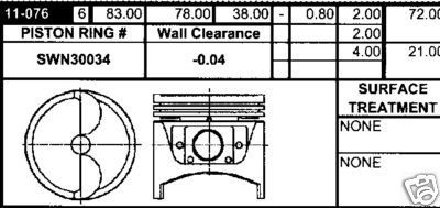

WogsRus Posted December 14, 2009 Posted December 14, 2009 Hi guys Well i am building my L26 and i want a set of pistons. I am going for flat tops with valve recesses and a N42 head shave 1mm for a 9.xx:1 compression ratio, more ore less still in design stage. I am havign dificuulty finding pistons in Oz for a 240/260z flat tops with valve recesses. I have found a set in the US from a L24E as per the atached pic from what i gather it has a 2mm ring 2mm ring and a 4mm oil ring, i got the bore and so forth but in teh pic it looks like it has valve recesses and a bit of a dish. Anyone got any ideas. the seller states the following hi the piston sizes are 83.00 mm diameter 78.00 mm length 38.00 mm compression distance (distance from top of the piston to the center of the pin) 0.80 mm recessed head 21.00 mm pin size what is the 0.8mm recessed head? also what is the L26 rods pin size? anyone with help would be great. PS. Where do i get a good set of pistons from? Quote

260Coupe Posted December 15, 2009 Posted December 15, 2009 Go to Stewart Wilkins and get a set of standard flat tops and then have them fly cut to allow for the valve clearance. You will have to measure the lift and duration of the valves to calculate the depth.....My L26 with flatties had approz 2.3mm fly cuts from memory. If you get really stuck then I have aset of Genuine Standard L24 pistons BNIB I may be willing to sell.....PM me if you want Quote
WogsRus Posted December 15, 2009 Author Posted December 15, 2009 well i will be shaving about 1mm of the head, depending what the CC of the head is after i have finished with it. As for cam that is a little undecided as yet, but i will most likely only run a stage 2 cam as they call it, so 270 with 0.46 lift i think. How do you calulate the fly cut depth? Sorry never had to customise stuff everytime previously i rebuilt engines it was stock for stock only. Quote
