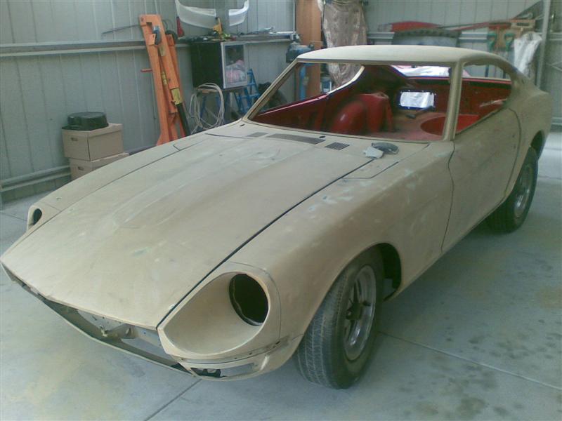

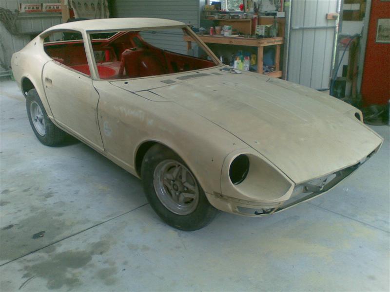

RB30X Posted June 15, 2010 Posted June 15, 2010 What are you doing to that bonnet? Sorry about the engine news :'( Quote
Scoota G Posted June 15, 2010 Author Posted June 15, 2010 The bonnet was smashed at the front so we cut the front off and will use the spare bonnet and some donor metal to rebuild the front. Quote

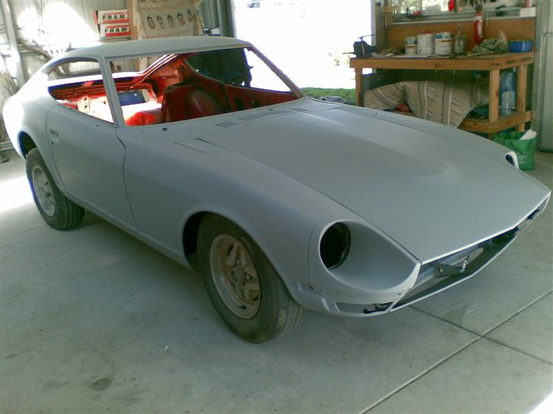

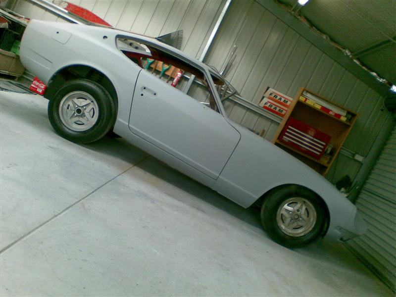

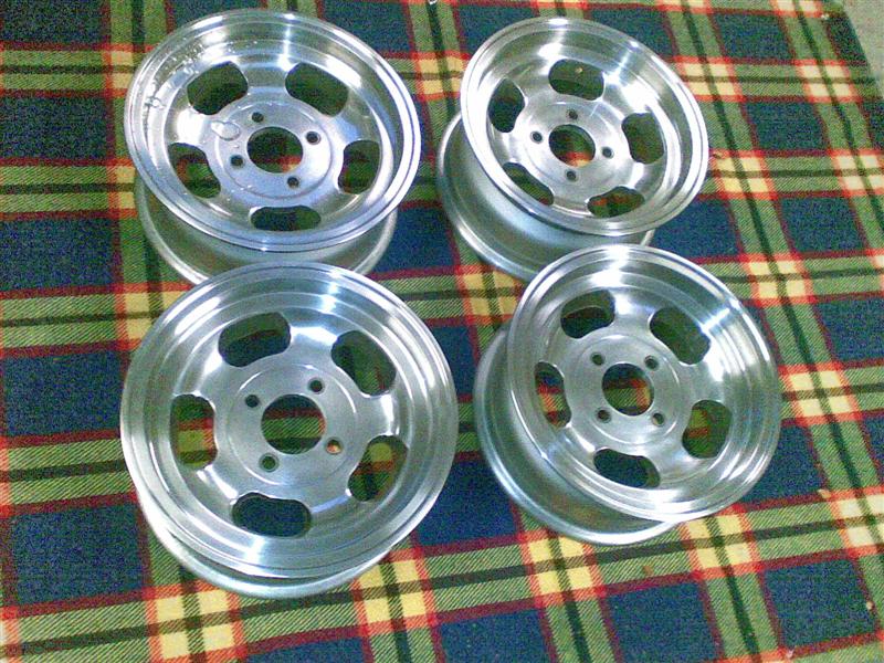

Scoota G Posted July 2, 2010 Author Posted July 2, 2010 Quiet here in Ballarat cause of the cold but Dale picked up his old school "Jellybean" 5 slots and i shot a trace coat onto the car. Quote

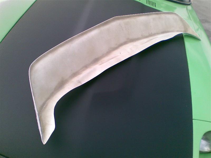

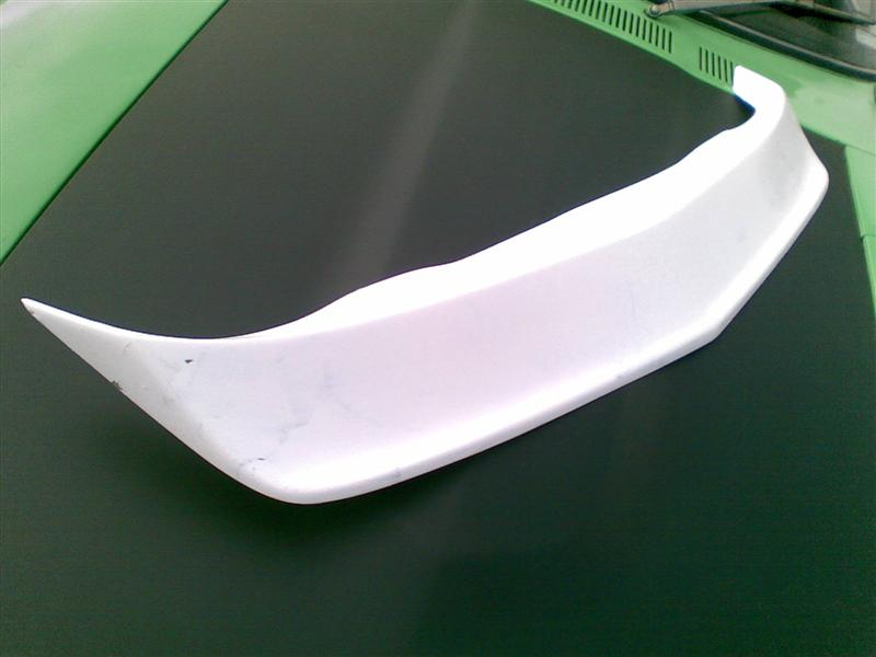

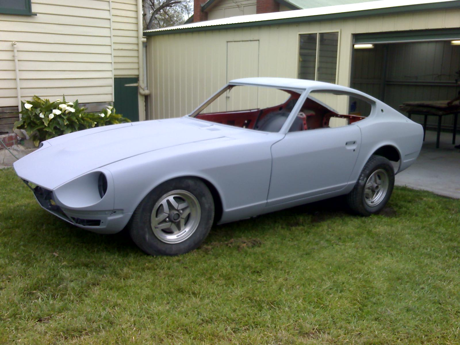

Scoota G Posted July 12, 2010 Author Posted July 12, 2010 This is the new spoiler. It's one dale had made directly fom the mould he made from the one he bought from the states. Quote

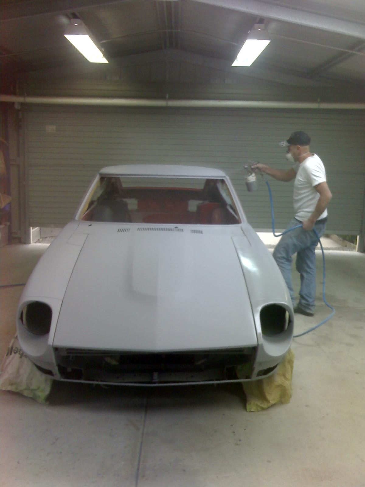

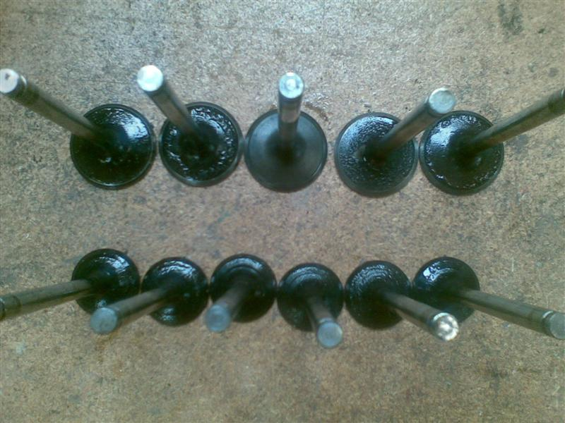

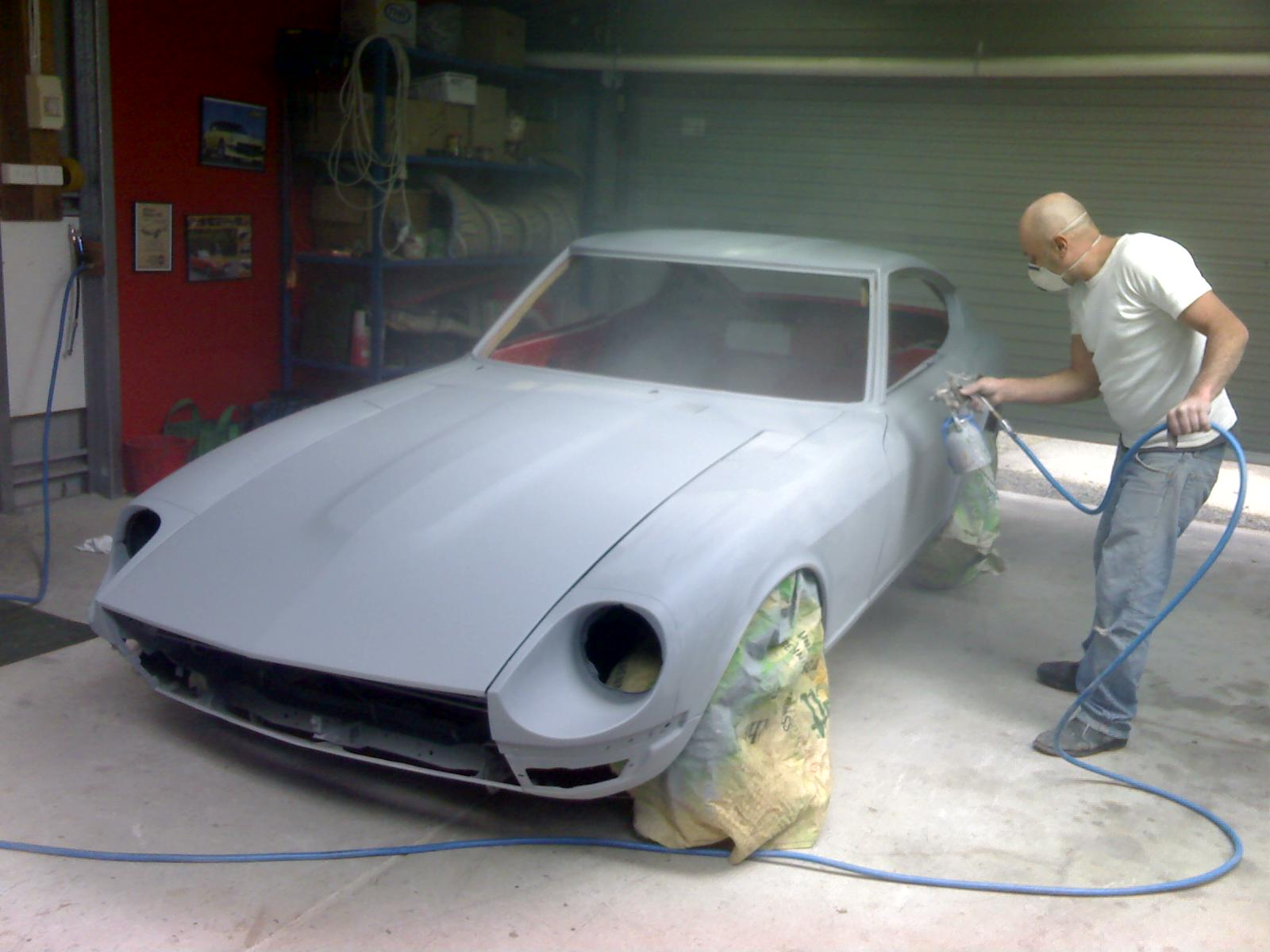

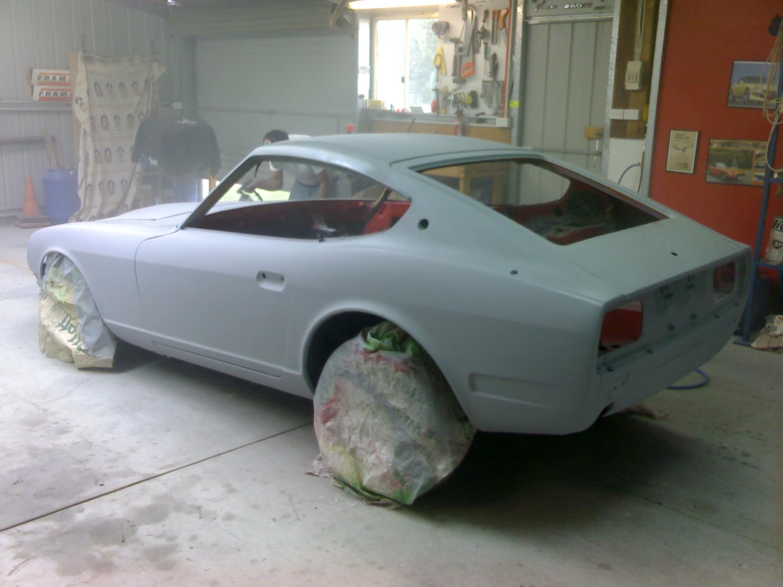

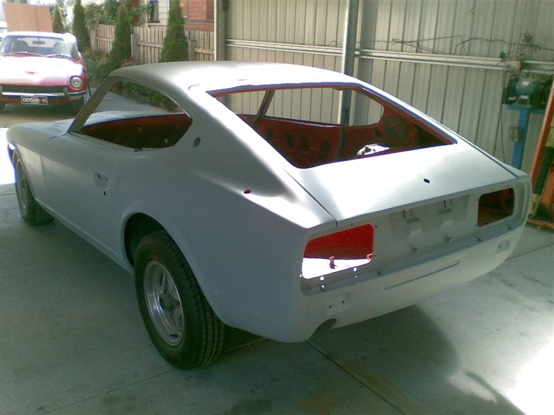

Scoota G Posted August 13, 2010 Author Posted August 13, 2010 Well both Dales L24's have a similar amount of wear (check out the deposits on the valves) so with both the engines stripped bare and ready to go to the machine shop, it's back to the build thread. No more hijacking by me. I cleared the garage/workshop and block sanded the whole car after the trace coat finding 25 seperate imperfections left on the body. Most of these will be taken care of by the next coat of Primer/ Filler. Then all we need is a reasonable day in Ballarat and i'll shoot the primer ready for the Top Coat. Quote

Scoota G Posted August 13, 2010 Author Posted August 13, 2010 It's a single part acrylic PPG item. Grey from memory. Quote

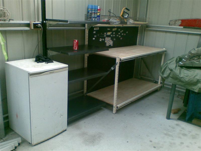

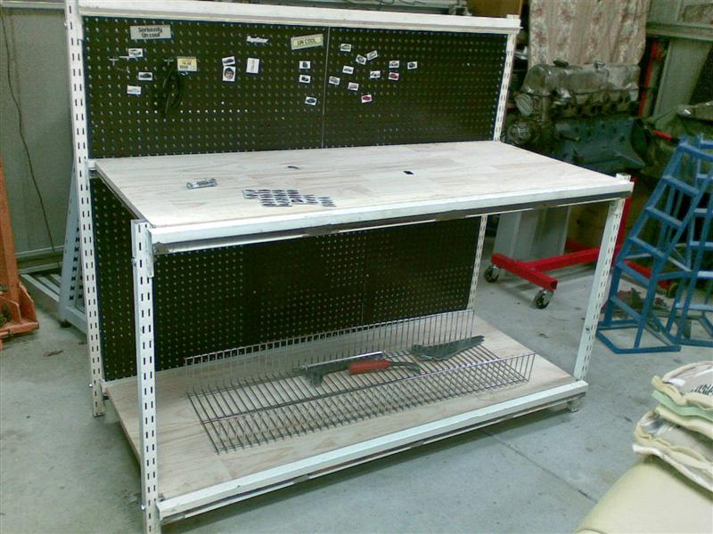

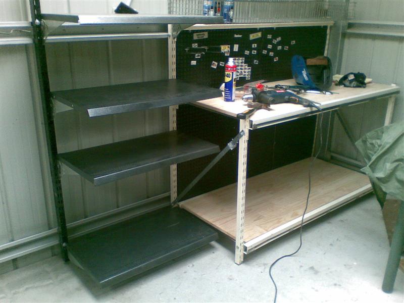

Scoota G Posted September 19, 2010 Author Posted September 19, 2010 With weather still holding us up we have been kept Busy constructing a new work bench from scrap steel we borrowed from the Big W skip. Came up well for just over $100. Quote

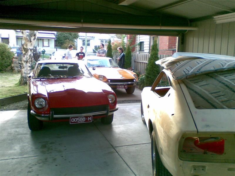

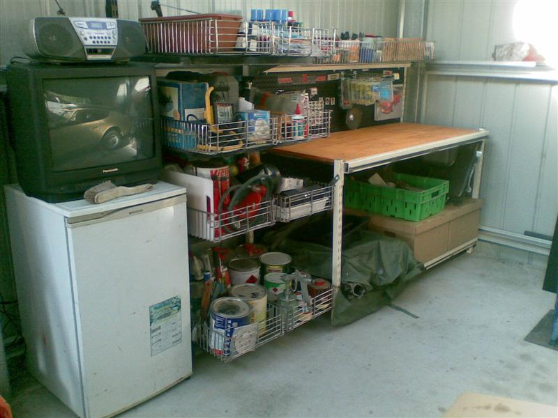

Scoota G Posted September 27, 2010 Author Posted September 27, 2010 Had a clean out at Dale's shed and a few member drop around. New bench is very handy. Quote
chris240 Posted September 27, 2010 Posted September 27, 2010 I love the reflection of the zed on the T.V. one in a million pic Quote

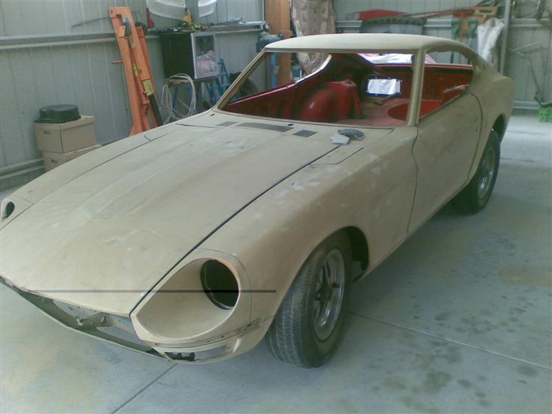

Scoota G Posted October 5, 2010 Author Posted October 5, 2010 Moving on up... it seems a soon as one is finished the other gets the Lovin it needs. Dale should like this, bodywork will be completed this week, ready to paint. Oh seen a nice rod at the paint shop today too. Quote

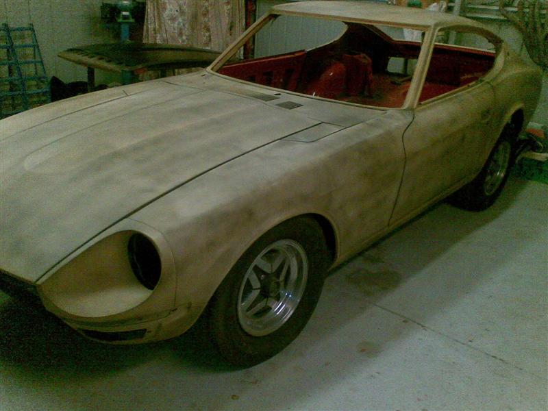

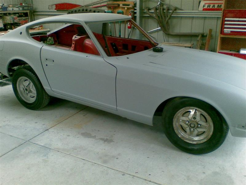

Scoota G Posted October 9, 2010 Author Posted October 9, 2010 Well after a week of switching between jobs i went on to complete all bodywork in preperation for paint. I'll really have to list the steps we have taken as it's been primer fill sand, primer fill sand and so on (including a dropped pot of primer in the engine bay) as it's been quite a process. Pics up and even i must say, orange is looking sweet and well on it's way back to recovery. Quote

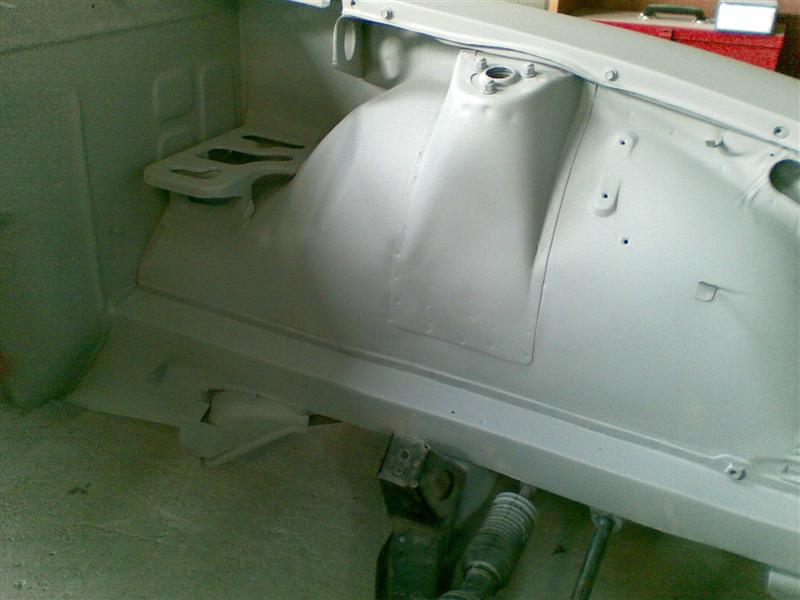

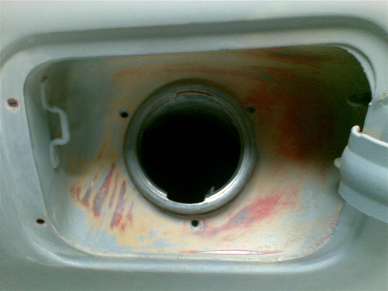

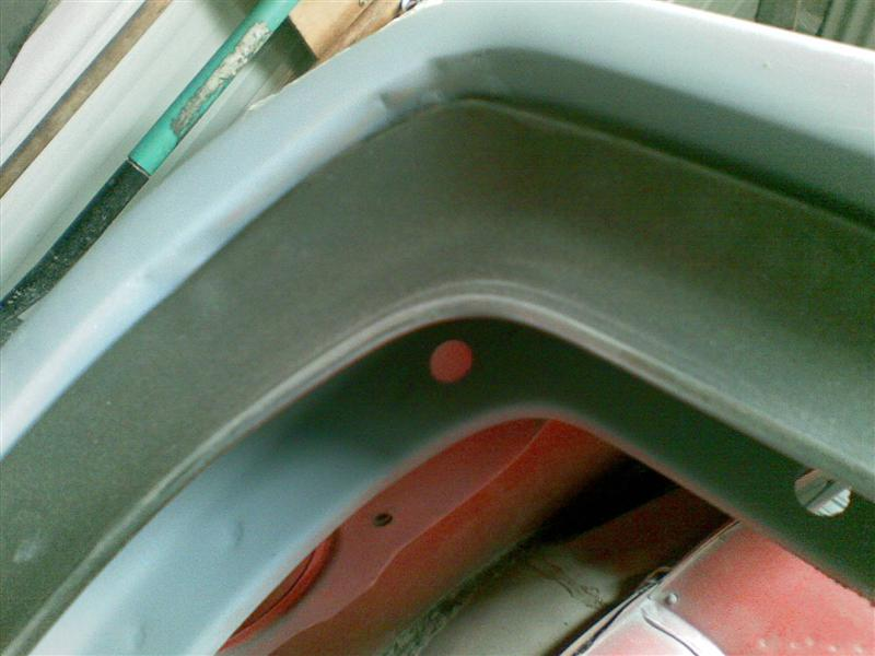

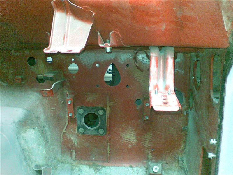

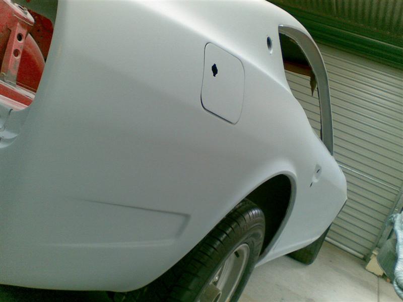

Scoota G Posted October 13, 2010 Author Posted October 13, 2010 Work continues in preperation for paint. Pedal box removed. Fuel filler reworked. And one bit i missed, i test fitted the rear tail light surrounds and just need to tidy up the area around the surround. I would have missed this other wise, on a near perfect body, would have ruined the whole effect. Test fitting is so important for more than one reason. Quote
