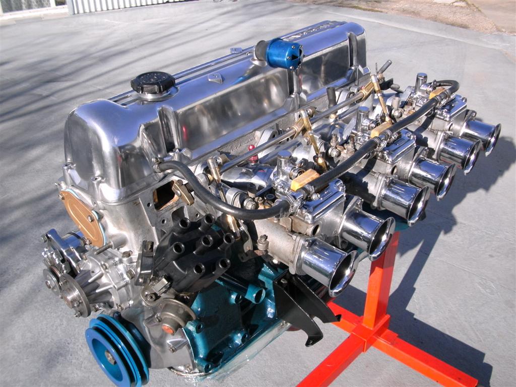

OZ001 Posted October 11, 2009 Posted October 11, 2009 my 240z is running abit rich and its getting me nauseous when im driving any help on getting this tuned?? do i adjust the knob on the SU's? this is my first carby engine Quote
Moderators Zedman240® Posted October 11, 2009 Moderators Posted October 11, 2009 I think it's been blabbed about before but try rotating those knurled knobs under the carbs in and then (I think) 2.5 turns out as a starting point. Then if you have access to a carby balancer, balance them! Check your plugs first to see what colour they are. Quote

chris240 Posted October 12, 2009 Posted October 12, 2009 hooold on... a few questions. is the car actually running ok when you drive it ? your assuming your getting nauseous because of the carbs, but it could be the carbs are sorta ok, but the residual gasses are entering the cabin thru the usual gaps.. SU's will always emit a little bit of vapour... check that the fuel tank breather hose (which runs parallel to the tank inlet hose) hasnt separated from the tank, its a common problem when the grommet shrinks and carrodes...if it has, block up the gap with some silicon to stop the fumes from entering the cabin.. Quote

OZ001 Posted October 12, 2009 Author Posted October 12, 2009 problem fixed (THANKS GUYS) it was the oil catch can going atmo which causes me to get all nauseous. just gotta re-route it. the carby are fine. lucky i work next to ian cummins who specialises in classic cars and i mean classics and restorations.. you gotta see his show room its awesome. guess ill be taking my car there for some rust removal. Quote
