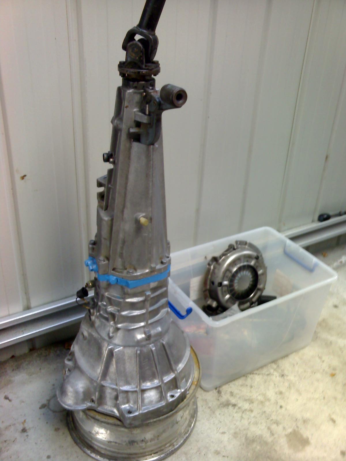

mattywood Posted September 22, 2009 Posted September 22, 2009 Hi I am looking for an early 240z box and want to know what I should pay for one. The model I am looking for is a 240z gearbox model # FS5C71A. This is from early 240z and is the same as used in the Fairlady. Quote
C.A.R. Posted September 22, 2009 Posted September 22, 2009 $400 for a 2nd hand one requiring new bearings and/or syncro rings. Quote
mattywood Posted September 22, 2009 Author Posted September 22, 2009 Thanks. Is that early model box hard to find? Quote
Administrators gav240z Posted September 22, 2009 Administrators Posted September 22, 2009 Thanks. Is that early model box hard to find? Getting harder now but I've seen a few floating around on Ebay from time to time. You also require a special driveshaft that is unique for this box. Lurch is about right on price and you can't guarantee it will be in good condition although you could get lucky. Quote
PZG302 Posted September 22, 2009 Posted September 22, 2009 Or you can do what I've done and convert the flange output to the later type using the later gear box rear extension housing..... Quote
dat2kman Posted September 28, 2009 Posted September 28, 2009 I got a few of the early 240Z boxes, three are the standard close ratio,(2.9 first) one is the mid close ratio (2.6 first), and one only ultra close ratio ( 1.8 first), most are set up for older Dato Sports 2000 motor, but can supply bellhousings and extension housings to convert to Z car use. I'm considering offloading one or two pretty rare, and these are rebui8lt with new bearings/seals etc from Lou M, but have been in my Dato 2000 race car, so they are "run in" reasonably well! They are all flanged output type ie 71A Quote
