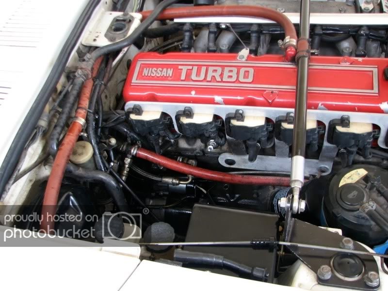

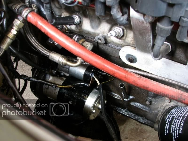

garvice Posted December 24, 2009 Posted December 24, 2009 Well I started cleaning my engine bay earlier this week, bit of painting parts, claying existing paint and removing/relocating extraneous parts. I also installed a new boost valve which is being controlled by my computer instead of the existing bleed valve. Few runs with the new setup and it was building/holding boost very steadily. It was a quick run and I got it home about 30 seconds after the last kickdown. I tell you all this because I open the bonnet and see this The gasket was on it's way out as I had noticed a bit of weeping at the front of the engine for a while, but still annoying. I had planned on pulling the engine out and pulling it down for a look (Previous owner did the rebuild but I don't know the state of the engine). However I wasn't going to do that until I got my shed built (won't be until ~ April). So all that was to say I probably won't be making the February show. If I pull the engine down before Feb, I don't think I will be able to stop at a simple head gasket, I will end up getting the while I am at it fever. Quote
RB30X Posted December 24, 2009 Posted December 24, 2009 So you played with your boost and suddenly you've got oil all over your block "down wind" of you dipstick tube (which is missing?). My diagnosis from those two pics would be a restricted crank case breathing system causing a build up of pressure, causing your oil dip stick to pop out and spray oil everywhere. Now it's either missing and you haven't noticed or you've removed it, but all they generally do is pop the seal and still sit there but with oil dripping out. Far better news than a head gasket if I'm right. Quote
garvice Posted December 24, 2009 Posted December 24, 2009 Actually not quite right. The boost did not go above 14 pound (which is what I had it tuned for and is much better controlled then the previous bleed valve, I have logging on the computer so can see how the boost reacted). I took the oil dipstick out to see how much oil I had and to get a clearer photo. Definitely leaking from head (although I hate to say it). Quote
