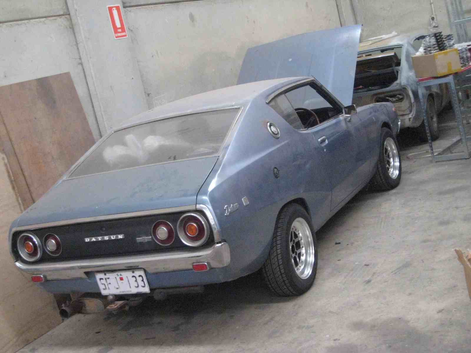

Here's a pic of my 240Ks. Hopefully between the two I can build one good KPGC110 replica. Spot all the fibreglass bits in the back seat  ;)

Nice has the JDM tails lights already :)
Actually those are stock, the two-doors sold here had those lights. I have two cars, one is a 240K GT and one is a 240K GL, apparently the GT badge made insurance too expensive so later examples were badged GL. For some other reason known only to Nissan they were also only imported as autos.

The stock export tail lights are very different - those are in deed the JDM tail lights :) people pay big $$ for them - there is a different ring for the GT-R version so you more than likely have the GT-X tail lights.
FYI export tail lights have a large clear ring on the inside light with the turn/amber in the centre of that. The outer is the stop/tail with a red reflector in the centre. Here is pic I found on the interweb
We never got the GL here in NZ all were GT's so I guess our insurance was/is different.

Interesting. Actually I just had a look at my second set of lights and they have the clear ring, but inside the ring is a reflector, the indicator is inside the brake light like my on my photo, not the same as the photo you posted.
The blue car was dead stock when I bought it, so possibly it was shipped with the JDM lights, or they were replacements for broken lights.

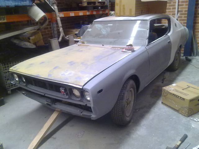

Getting started on the bodywork now for the Feb 74 car which was already stripped. Plenty of minor rust repairs, but not as much as I had to do on the zed. I put the replica GTR grille on to give me some inspiration. The black front panel is a Restored fibreglass piece which fits perfectly and saved me from trying to find a replacement somewhere.

hey that looks just like the same shape as my 72 180b sss  do they have irs or solid rear axle jeez getting pretty rare now ,nice one
Not the same chassis if that's what your getting at. All the 6 Cylinder K's were IRS. These were GT's rebadged as GL's. Some minor differences between the "real" GT's and the following GL's, I think it was mostly to do with Nissan not competing in Japanese motorsport much in the mid 1970's, at least not with the C110. Apparently the GT's had bigger disc' brakes than the GL that replaced it, but the GL had a 5 speed, whereas the GT had a 4 speed gearbox. The GTR had rear discs too.
