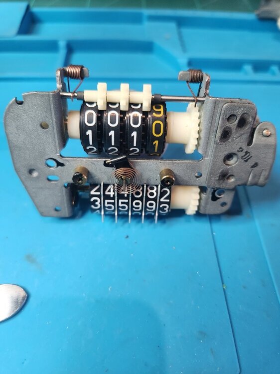

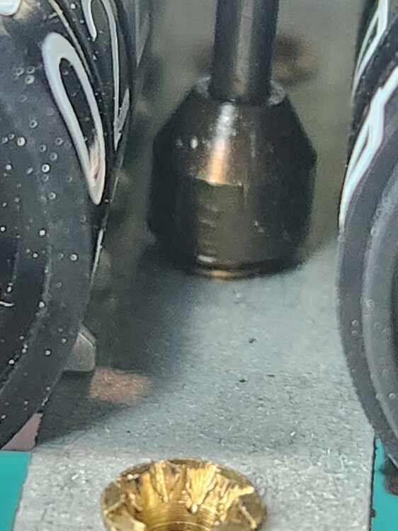

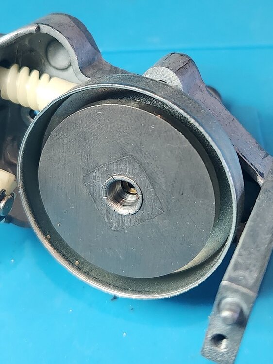

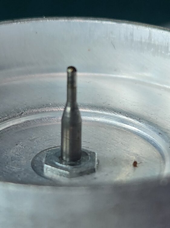

Oversteer Posted January 27, 2024 Author Posted January 27, 2024 (edited) So I pulled the speedo out, and as soon as I had it in my hand I heard the clacking noise it makes while driving/bouncing.... Pulled it apart and is surprisingly clean in side... its the magnet drums making the noise...such tiny little bushes and pins, looks tricky to fix any play in these items ! Edited January 27, 2024 by Oversteer Quote
