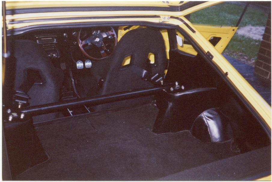

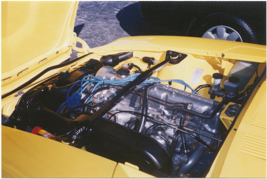

NR240 Posted May 19, 2005 Posted May 19, 2005 A company called Brown Davis in Bayswater made mine. Just a question, why would you want adjustable strut braces? Quote

NR240 Posted May 20, 2005 Posted May 20, 2005 I see what you mean. For a mass produced strut brace, the adjustable concept would mean that it is going to fit most cars given the fact that each car is going to be a few mm's out here and there. However, if you are going to have them made to suit your car, then "adjustable" serves no purpose. well not that i can see anyway. I see the quoted Whiteline price of around $200. I paid about that for mine which were made to suit the car. Depends on what style you like best i suppose Quote
Natez Posted May 20, 2005 Posted May 20, 2005 my friend got a non adjustable stut brace for his 200sx, it didn't fit onto his 200sx, never been in a accident etc etc, he got a adjustable one and it fitted.... so a mass produced one is worth getting adjustable, otherwise if its custom, no point making it adjustable unless you arn't that confitable taking proper measurements or something or you want to try and pull back you struts a few mm, whic ive also seen done... Quote
