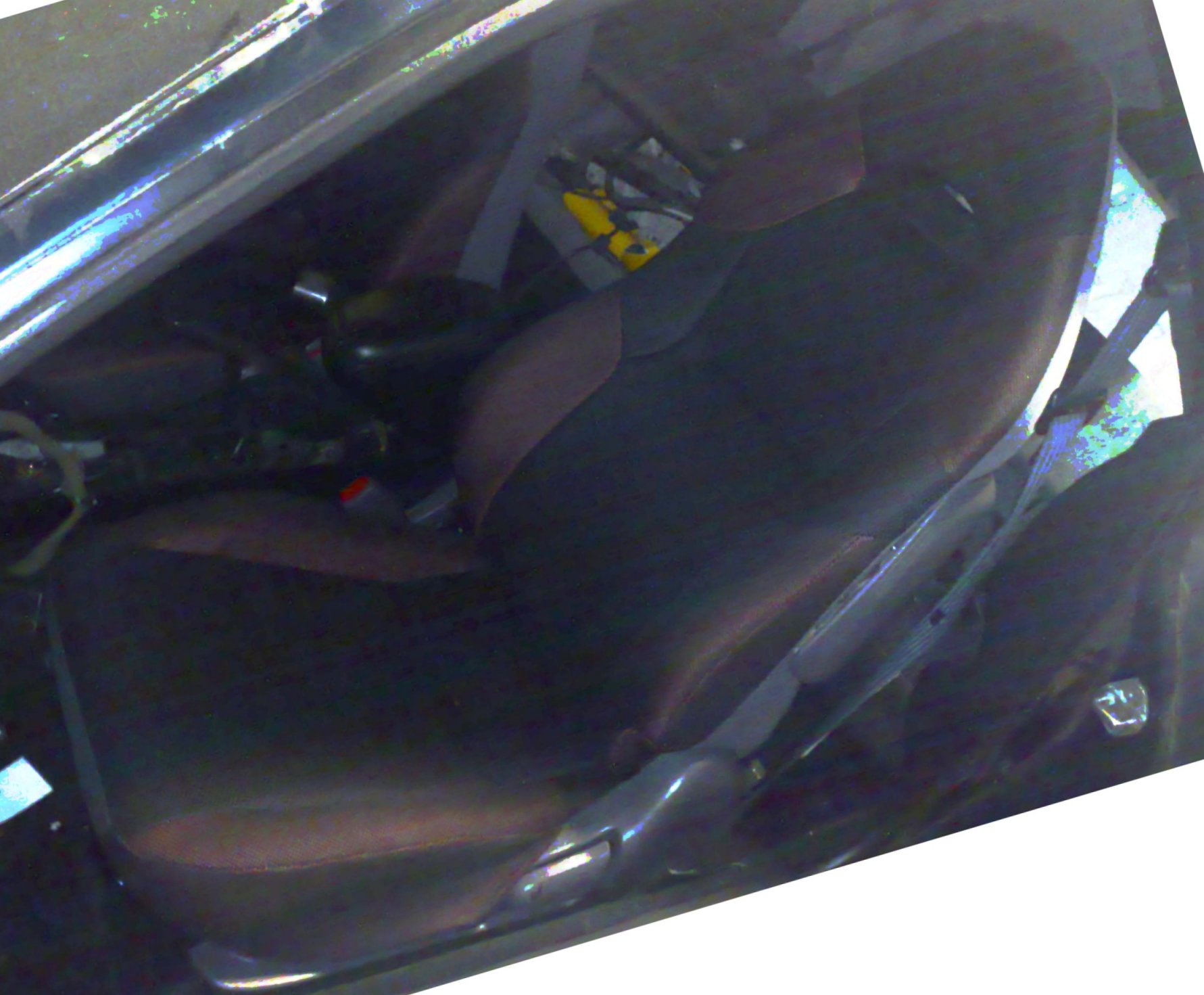

Sirpent Posted April 21, 2009 Posted April 21, 2009 Hi All, Smart Arse here (I hope I'm not putting ppl off with my posts) These are the seats in my parting out Ford Probe that I installed when the factory drivers seat collapsed, they are out of a 2002 Celica that I picked up from a Toyota wrecker, I'm thinking of using these in My Z project. Nice and thin like the original Z seats, have full adjustment, plus have a side hand mechanism, and additional rear foot mechanism to allow it to fold forward so they would be good for 2 seaters or 2+2's. Just an idea of course. I paid $150.00 for them in mint condition, the side airbags built into the seats went off so they were worthless to the wrecker, I cut the bags away and re-secured the air bag trims which just pop off when they deploy. Cheers John Quote
