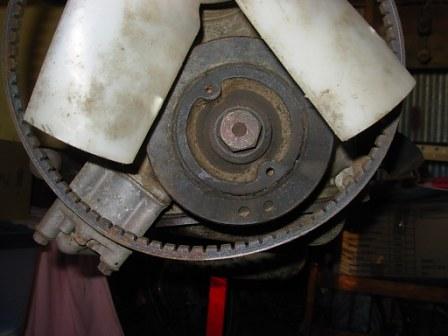

bluerat Posted April 11, 2009 Posted April 11, 2009 Howdy, can anybody tell me if this Harmonic balancer is the std Nissan Jobbie??, or something else? Cheers. Quote
Mr240z Posted April 11, 2009 Posted April 11, 2009 STD datsun..Just replaced mine, Looks the same.. Quote
bluerat Posted April 11, 2009 Author Posted April 11, 2009 Thanks Mr Pauly, looks like I'm up for a spend then! Quote
