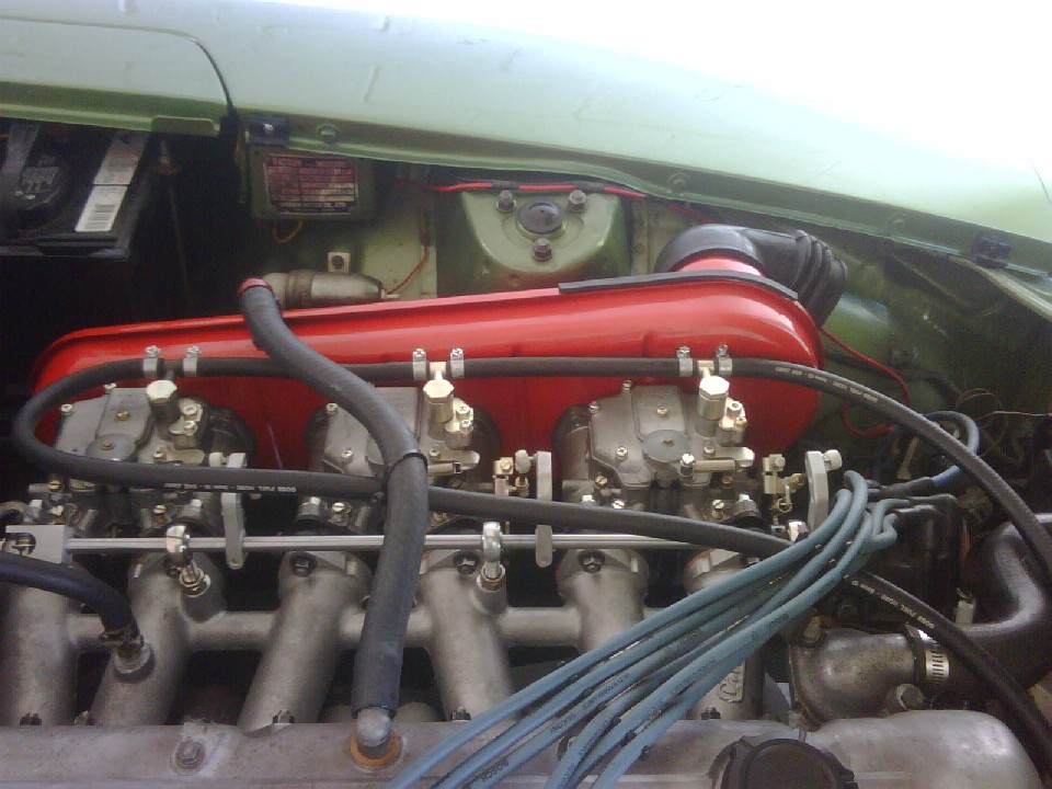

This is my attempt at making a balance tube on a Kameari manifold, it runs the PVC valve and the auto transmission modulator. My first attempt at making a balance tube looked like a giraffe raping a seal :S
