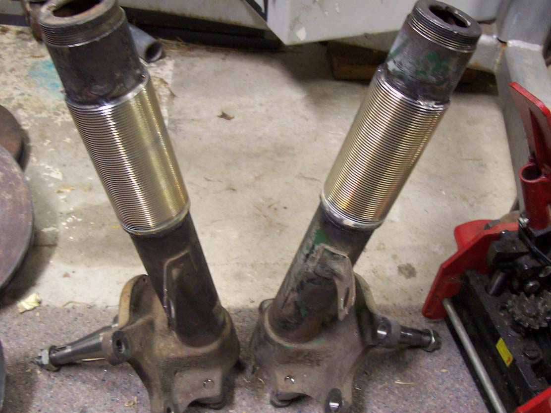

ZEDMAN240  -  Thanks for that pic - thats a nice set of struts. Are you going to use mr2 inserts or something else?
They are already in the car with shortened Koni Red's. If you know anyone with a lathe, I think you could make your own top hats out of some alloy. Simple by the look of them.

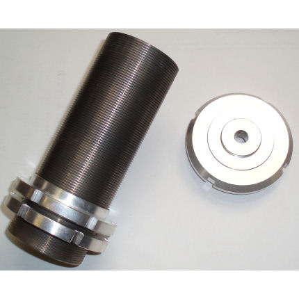

Most of them are alluminium - you weld on a little bung and the threaded collar sits over the top of that,
Thats how these ones work,
http://www.ground-control-store.com/index.php & http://www.technotoytuning.com,
TechnoToy sell GG gear, but there customer service is excellent!
But it is all pretty straightforward stuff - cut of the spring perch, weld on the bung at a certain height (which TTT will give you) put on the collar, re-install into the car,
Can even retain your stock rubber insulators if you like,
