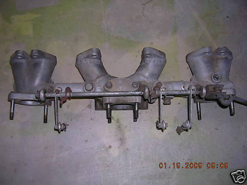

Scoota G Posted January 19, 2009 Posted January 19, 2009 This manifold has been custom made. http://cgi.ebay.com/ebaymotors/Datsun-240z-260-280-Triple-SU-Intake-Manifold-RARE-JDM_W0QQcmdZViewItemQQ_trksidZp1638Q2em122QQcategoryZ34198QQihZ015QQitemZ250360000753QQrdZ1QQsspagenameZWD2V Quote
NZeder Posted January 20, 2009 Posted January 20, 2009 One does have to ask why? Triple DCOE/PHH/DHLA yes as there is a throat per cylinder and Twin SU's due the firing order etc but triple SU's does not work (well it works) but there are better ways to do it and 3 SU's is not the best solution. :-\ Quote
Moderators Zedman240® Posted January 20, 2009 Moderators Posted January 20, 2009 I think its just for cheapness...just have to find one SU to finish it off... Daniel Moore made one a while ago; got some good results. Quote
zzzzed Posted January 20, 2009 Posted January 20, 2009 this manifold also takes two different size su's. I think it has been made from a L18 SSS and an l24 manifold and the middle runners are longer than the outside runners Quote
