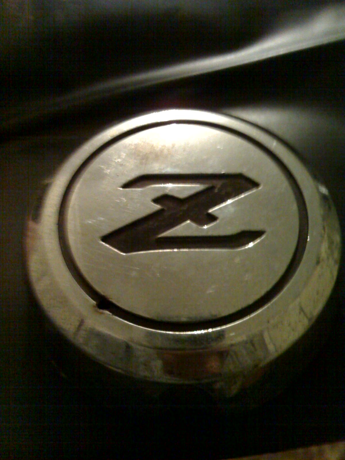

Toecutter Posted September 23, 2006 Posted September 23, 2006 is the above pic your locking "button" thingo??? If so where did you get em looks good! Quote
alexcs Posted September 24, 2006 Posted September 24, 2006 Not sure what it is from,I had it given to me it had been screwed to the front of a 1200 ute it may be a center wheel trim from a 280 Quote
