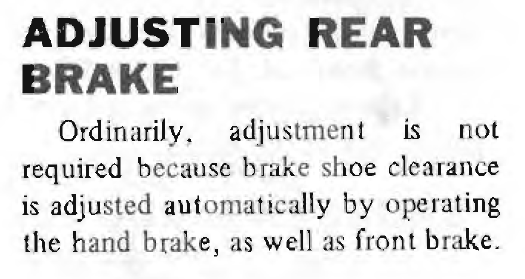

2 hours ago, Mickl said:
Bled the brakes etc but now the handbrake is not coming on
From memory you will need to pull and release the handbrake multiple times to "readjust" the rear brake shoe setting.
Edit: image.png.f3ce59ab65a39444483a68bfea7753f2.png
Edited by AndBir
added text from FSM

Thanks for the rapid responses. I should have mentioned that it is a77 model with the self adjusting mechanism.
however, I took a drum off and applied the handbrake 50 times or more and the self adjust lever does not activate the star wheel. That is why I was trying to get at the adjuster from the back of the backing plate......and it seems impossible to crank it from here.
I did turn it about one rotation to push the shoes apart a bit but any more and I can't get the drum back on. I am thinking I might drive it a bit and wear the shoes in and maybe I will be able to remove the drum a bit easier and crank it another turn or two?.
