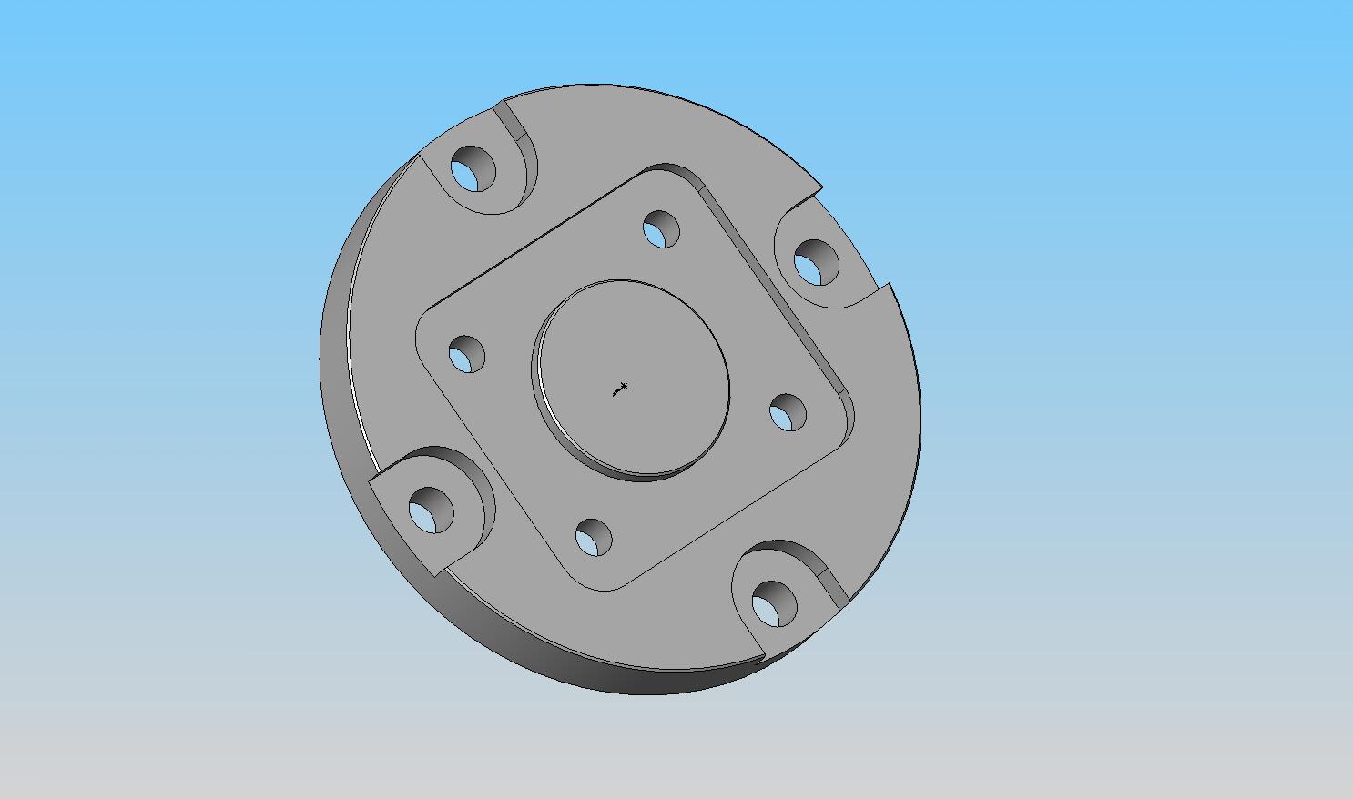

luvemfast Posted October 22, 2008 Posted October 22, 2008 Here is what I have used to use Z31 CV's in my car, I have an S130 so it will differ to S30 cars. But the concept is the same. I beleive you also will need 2 pairs of half shafts from a Z31, they are not even in length and you need the 2 shorter ones. I highly recommend recessing hub into adaptor as shown here, it uses a dog type drive. Version 1 didn't and my car was left on the Haunted Hills track with sheared bolts. Should have known better, but I got lazy. Turned out to be an expensive day, $40 a lap plus trailer hire and petrol........ Lesson is do it once, do it right. Quote
