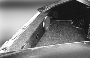

Hunter Posted September 18, 2008 Posted September 18, 2008 you could mount your speakers like the pic below, I think this pic was off MSA or http://www.blackdragonauto.com/ It would be easy to make your own box though, The box is even large enough for a port and directs the sound straight to the front of the car. I think it was $150 on the site to purchase from memory. Quote
sexual_sushi Posted September 18, 2008 Posted September 18, 2008 ive got one of those msa speakerboxes in the back of my yellow car, looks stock and has great sound. I'm a bit of an audiophile and like a nice setup but these are just 2 pioneer 6x9's running straight from the head unit and they look great and are more than loud enough for highway driving. has a nice bass note too considering there isn't a subwoofer. only problem is when the back is loaded up with bags and car parts it gets a little muffled, but thats only when the backs chockas Quote

herrods Posted September 22, 2008 Author Posted September 22, 2008 Im not too keen on those rear speaker boxes because you cant get to your spare, which for some would really be an issue, but i'm just finnicky. i'm thinking of making something that recesses into the left and right extreme back corner, but doesn't interfere with the rear panel of the car, the only thing it might cover is part of the light access panels. Quote
