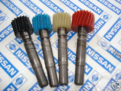

I found these items on E-Bay, Has colour coding of different speedometer cog sets.
http://cgi.ebay.com/ebaymotors/Datsun-240Z-280ZX-Differential-Speedometer-Cog-Set-NR_W0QQcmdZViewItemQQcategoryZ46104QQihZ021QQitemZ310066058155QQrdZ1QQsspagenameZWDVW
Up for bidding is this set of (4) speedometer cogs for your Z or ZX.
This set includes the following cogs:
Black (3.545:1)
Blue (3.70:1)
White (3.90:1)
Red (4.11:1)
This is a great set to match various differentials to get accurate speed readings.
Can someone confirm if these details are correct?
