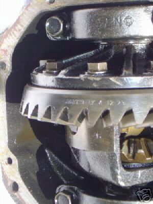

Administrators gav240z Posted December 5, 2005 Administrators Posted December 5, 2005 To find the ratio of a differential you need to take the cover off look at the crown wheel(The large wheel with teeth). Then then take a look at the pinion which also has a set of teeth but is the small part. Now you can count the teeth on each or you should be able to find a number in the format for example 37:9 if you find this number it's a simple task of dividing the numbers by each other 37/9 = 4.11111111 or 4.11. I hope this helps since I didn't know this till I read it on an item for sale on ebay. Quote
