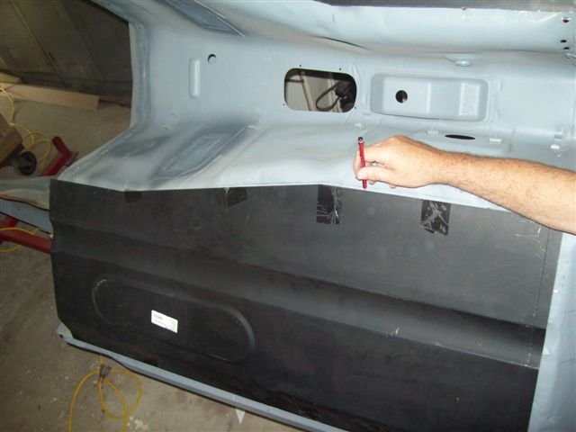

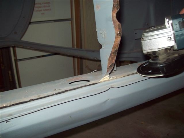

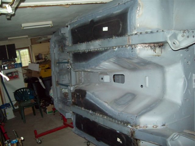

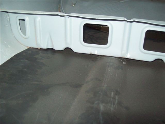

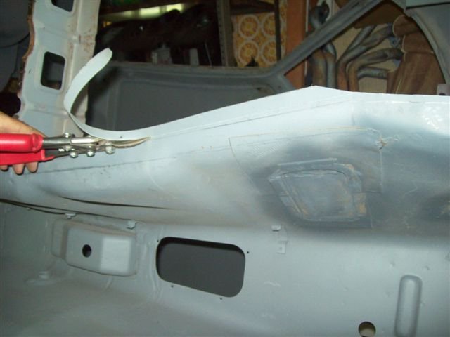

I don't understand why you would need to reshape the new floors.
Use butt welds. If you use lap joins you'll just encourage rust.
I trimmed my new floors then laid them over the old ones and marked out a cut line. I cut the old floor out with a thin cut-off wheel in an angle grinder and snips.
I then positioned the new floor and welded it in position. I then added new rails.
I did it on a rotisserie but it shouldn't be any different welding from inside the cabin.

Man those look really good!!! I was told that the fitment wouldnt be the best so i would have to work them into place bit i guess that would be for more of a lap weld with that type of fitment.
