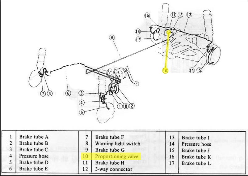

PeterAllen Posted May 12, 2019 Posted May 12, 2019 (edited) You may want to research this further but my understanding is that it is not a proportioning valve at the rear of the car. It is a device which allows more fluid to drain from the rear slave cylinders and thus ease the shoes away from the drums. It creates a tiny reservoir in the line to the rear brakes and the brakes subsequently run cooler but also take a little longer (nano seconds?) than the fronts to start working. If you have rear drums you should keep it, if you have rear disc you don't need it but I suspect it doesn't matter. https://postimg.cc/yJDCG08w Edited May 12, 2019 by PeterAllen Quote
my_mad_z Posted May 13, 2019 Author Posted May 13, 2019 Hi Peter, Thanks for the info. I converted the rear from drum to disc many years ago; looking at the Haynes manual and other resources online, they label it as a proportioning valve so that's why I used that terminology: I'm suspecting there may have been an issue with my 'Warning Light Switch' (item 8 ) because after deleting it, the pedal and brakes felt much better. Quote
