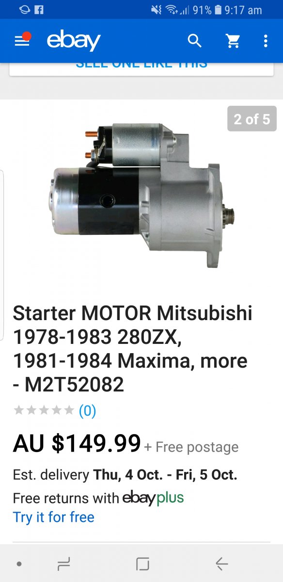

I bought a  280zx reduction gear starter motor off ebay for $150. One of the best upgrades i've done. Starts easier and is quiet in operation and half the weight.
