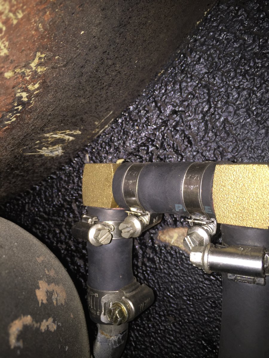

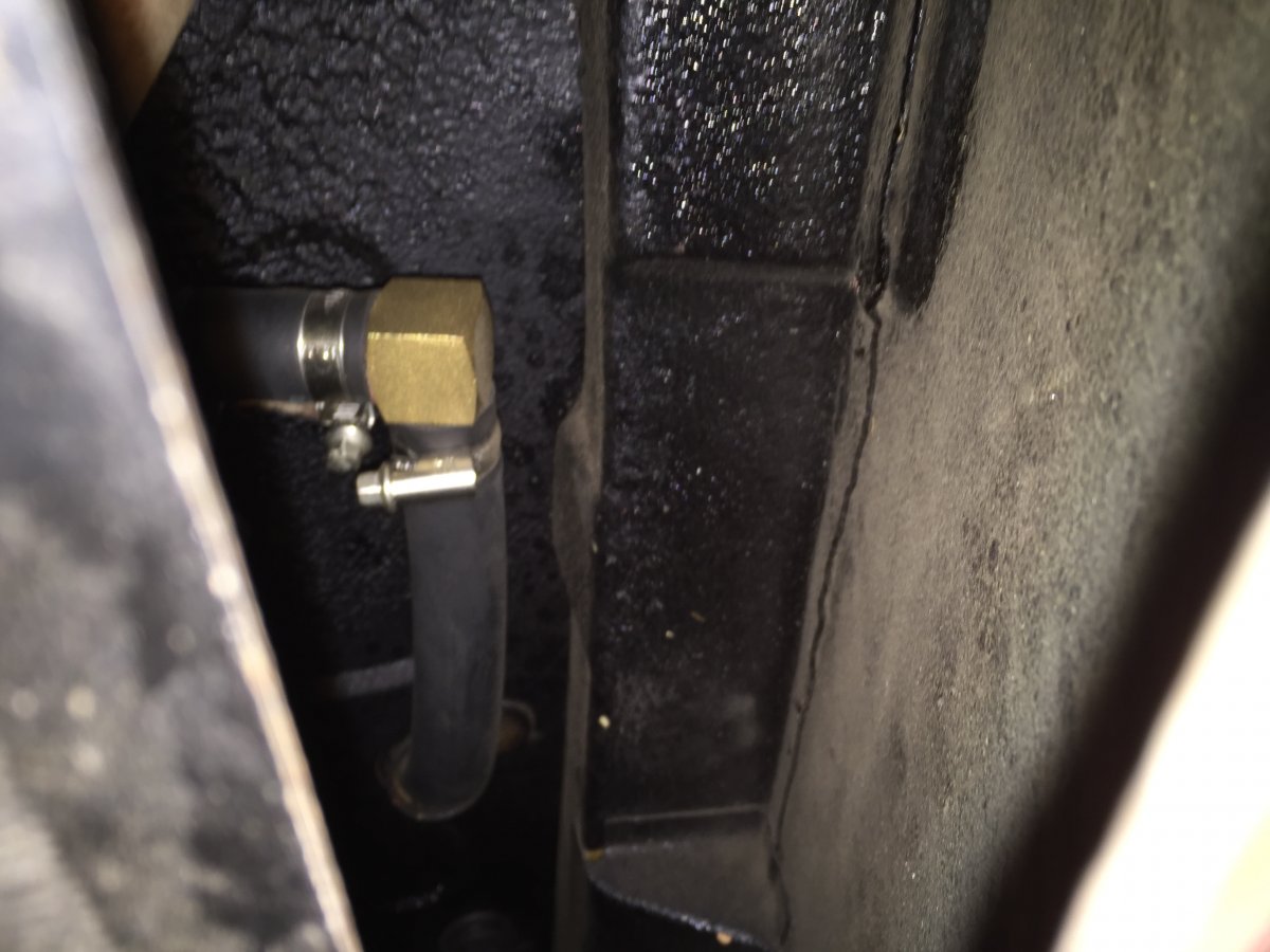

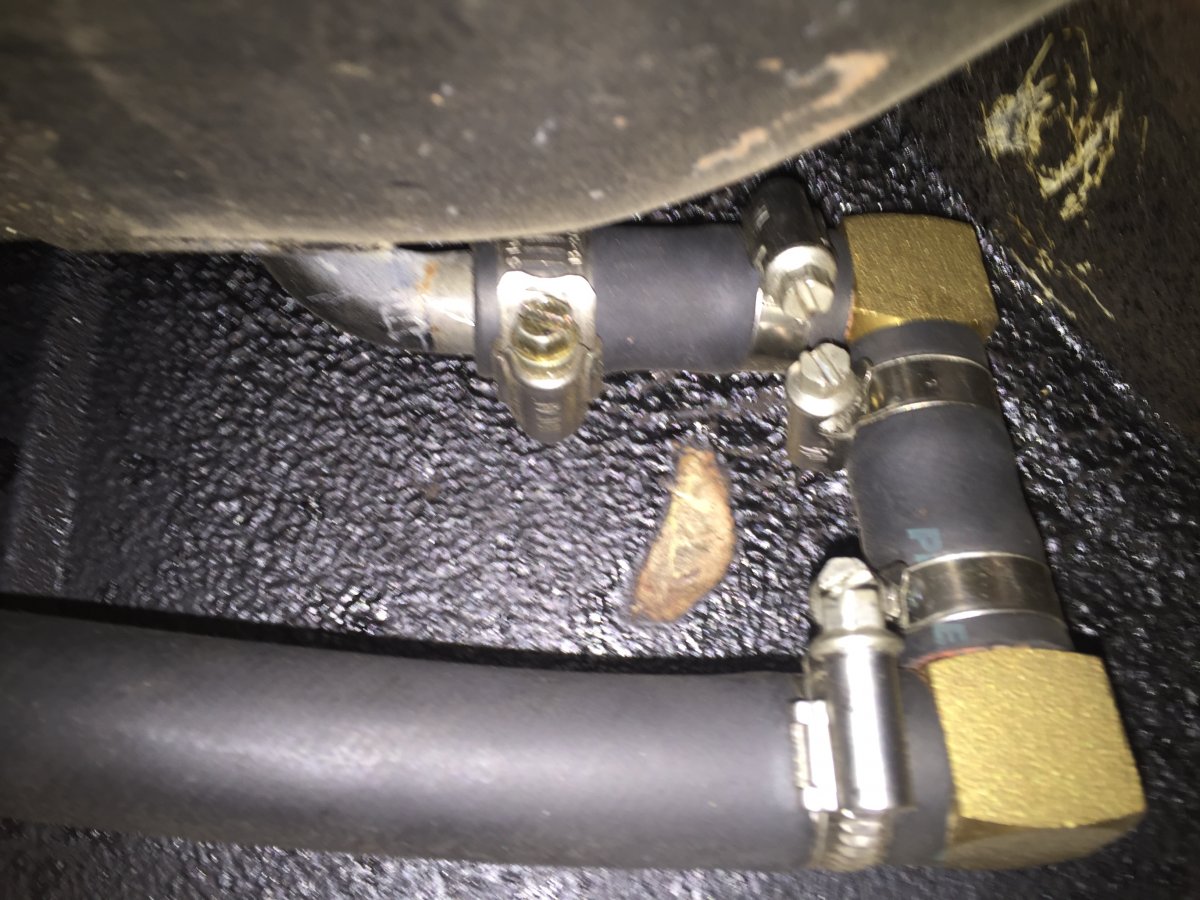

I replaced a section of my vent hose ( the bends near the tank ) due to splitting, I could not find the same size hose with bends so I went to Pirtek and got the same diameter hose, joiners and brass bends to suit.

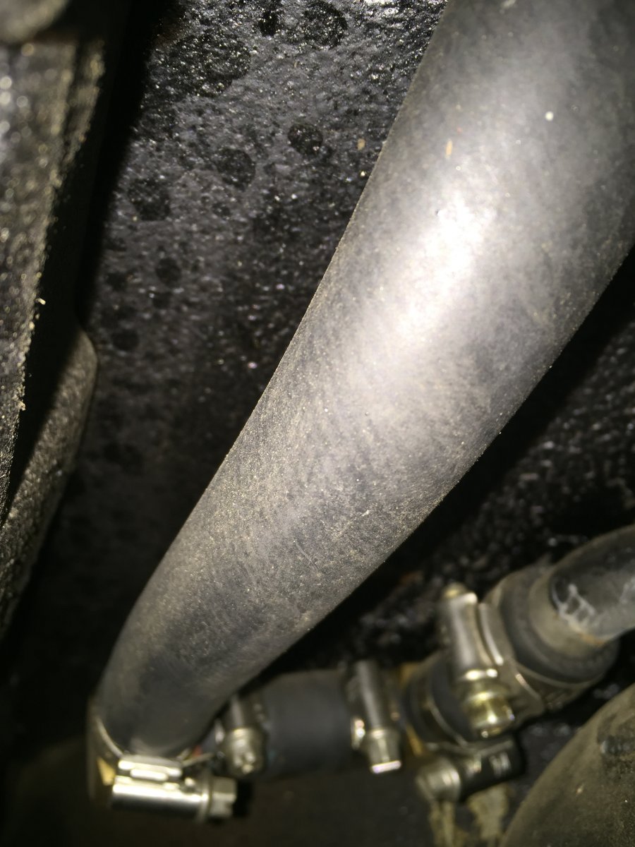

can I confirm in the photo you have posted, that the top right corner is the spare wheel well and that the hose exits on the left and comes back into the car to the fuel filler hose?
As I'm measuring everything up it all seems very tight (even using the actual OEM hose) to make this all fit properly.  I'm sure it will just take a bit of tinkering but the more info the better.
cheers
Jason
Posted (edited)
Hi Jason,  yes that’s correct it exits the tank and heads towards the wheel well then does a u turn back towards the fuel filler then through the hole in the floor. I had to loosen my tank to replace the hose, limited room to move.95722F65-E08C-4502-A839-2701FD365EE5.thumb.jpeg.6ba0801acc54780eb1159be3f9a517d2.jpeg0CC7A3C0-E290-4C5D-B617-E5C9BFF6E377.thumb.jpeg.056222704e8c1deebdeea16b243adcaa.jpeg58F437B8-2226-4833-B537-08129DE55D0C.thumb.jpeg.897550877ea1193d5916593ff0fc85b8.jpeg
