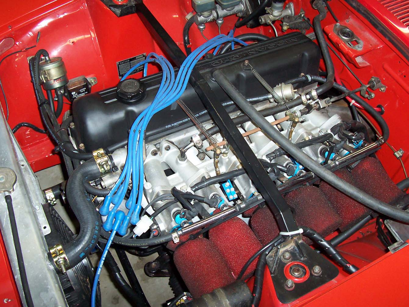

I am looking at putting some strut braces in my 260Z
I would like to see what setups people already have installed.
Be that Custom or Store Bought.
Prices and any technical issues with your installs would be great.
My front brace is the DIY type that can be made out of that blue square tubing and 20 cents worth of steel plate and the rear comes with the $1200 cage....

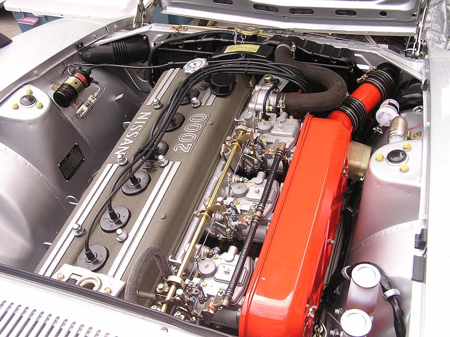

And an engine I wish I had in my engine bay.....

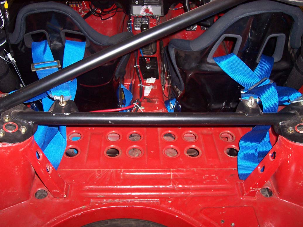

The roll cage was fitted by Brown Davis in Bayswater. Would like to drive a turbo L28 one day....never had the pleasure!
Here's a pic of my strut brace in my 240. It is a custom job with rose joints at either end to tie into the strut top mounts and give us some adjustability for length. The front end of my car has also been seam welded to stiffen it up considerably as the rules don't allow for the cage to extend into the engine bay.
The rear strut brace is part of the cage.
