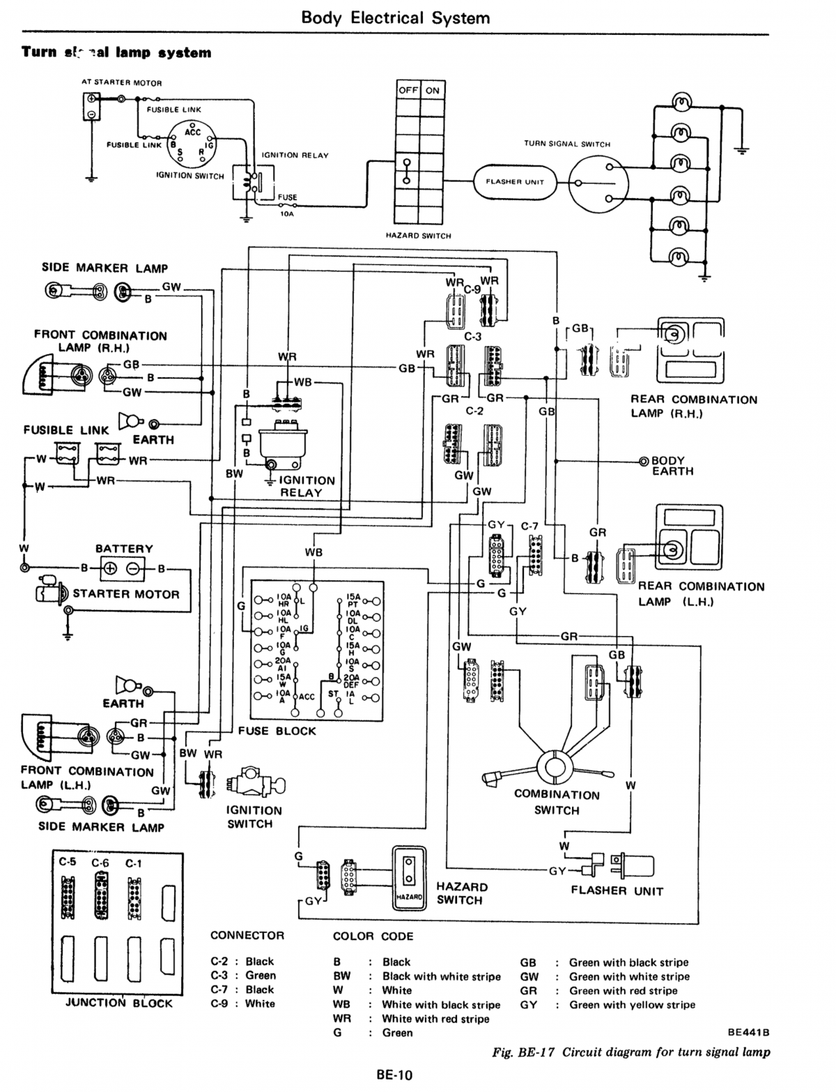

If reference is made to http://www.wedophones.com/Manuals/Datsun/1977%20Datsun%20280Z%20Service%20Manual.pdf- page 506 or in the attached image, the side indicators and the front and rear indicators seem to connect and earth at the same point as each other.
However, it's been a while since I have looked at electrical diagrams.
The rear wires are easy to access so I will play around with those first to see if I can find the issue.
