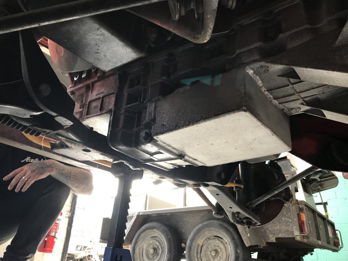

I got the engine in on the weekend and surprisingly the tunnel will not require major mods, I need to get the sump modified and chop about 40mm out of the front of it to get the engine to sit down a bit lower in the bay, this may be tricky though as the oil pickup in the fg engines are in the front I believe and that's what the hump/channel is for in the front?

Good to see the progress, a lot of LS engines are rear sump with the pickup coming from the front. May be able to adapt something but there are probably other solutions out there in google land.
there are a few photos, the engine and gearox are just sitting in there at the moment, at this stage we havnt made any mounts up just sat in there, I the newxt few week I will no doubt have pics of the mounts etc
yeah I have seen a few ideas and ill see which one turns out best ill update pics when I do mod the sump

40mm on the sump sounds a lot less than mine thats needed. in the pictures ive currently mocked mine up with the specs of the Atomic dry sump you can get, with 10mm clearance off the cross member. it still sights bloody high and a 4inch reverse cowl barely covers it (dont mind the 'list' on the wind screen either it justs keeps growing haha). you might be able to drop your cross member too but its something id rather not stuff around with and make it fit whats already there if possible.

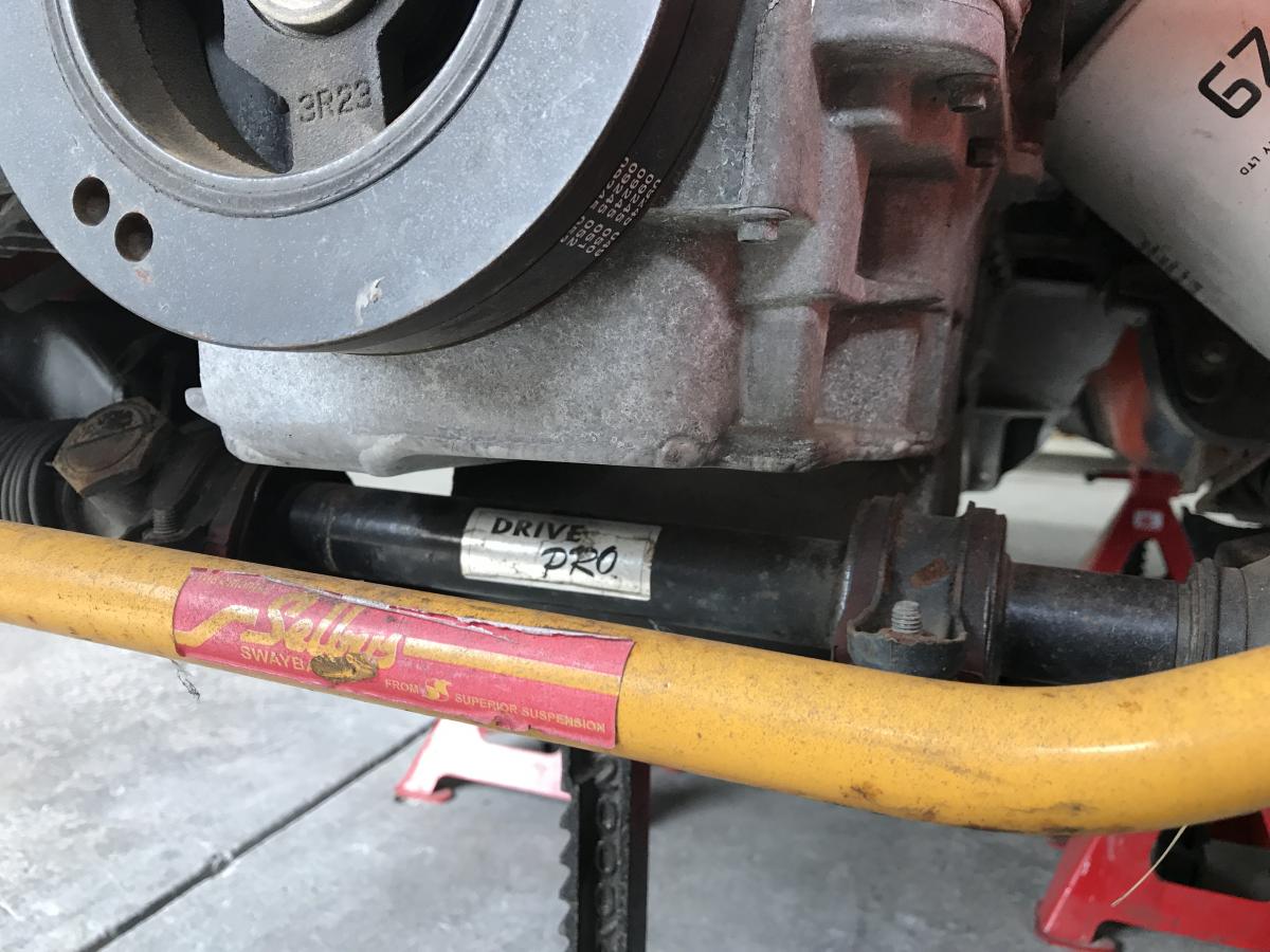

So here are a few more photos of the engine conversion, the ford mounts we used where ba/bf mounts as they come out nice and flat off the side of the block, believe it or not we used ls1 engine mount rubbers and they fit perfect into the ford mounts even with the little locating tab, we used these because if I end up breaking a mount they are plenty available and not so expensive to replace if need be and are low profile, we made the mounts out of angle iron 65x65x5 mm, we are using three bolts through the top of the mount and 2 in the sides with crush tubes welded in the chassis rails, coming off the angle where the engine rubbers sit is 6mm plate with gussets welded in for extra strength, the trans cross member uses the factory ford zf trans rubber, these will also have 3 mounting bolts per side with crush tubes welded in and plates in the inside of the cabin for extra strength aswell, the wiring is being modified by CAE performance in Victoria and should get that back very soon hopefully, looking to have running and driving soon so im very excited for that,
Still a lot more work to be done mounting and all that so I will keep updating photos as I take them, my mate who is helping me  works away and my car is a his place so we only really get a full day working on it once a week but we are making great progress

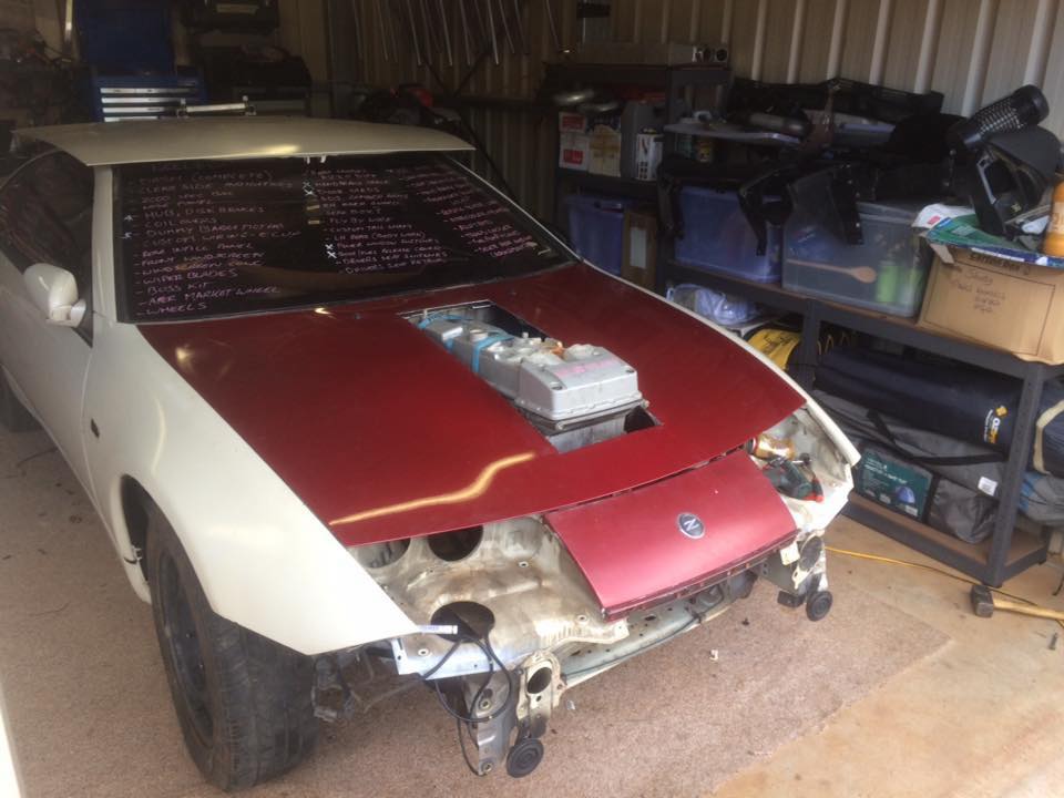

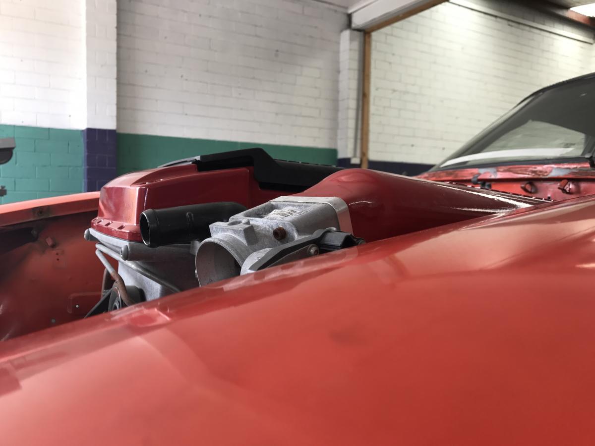

Have you had any thoughts on how to get around the bonnet clearance issue?

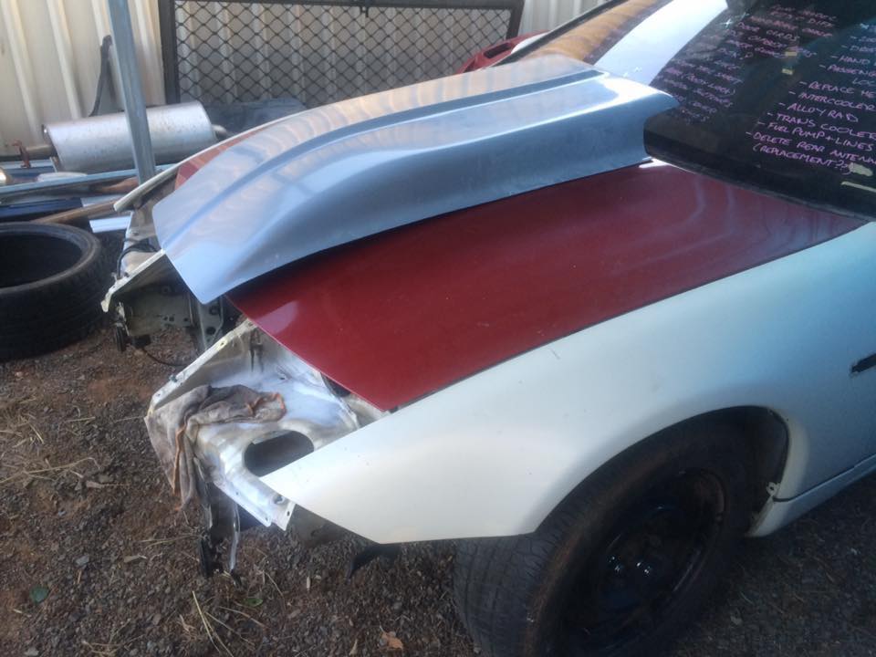

Yeah I will have to widen the hump in the Bonnet by about 30-40mm and add some height to it aswell, about 10-20mm we got the engine as low as we could without modifying the sump, my barra has a factory rear hump sump and the oil pickup runs from the front of the engine to the back to modifying the sump would sit it 5-10 mm lower but I didn't want to go that route,

Also runs a modified nizpro intake which takes up a whole lot of room where the bonnet should be, so I'm thinking when I make a new exhaust manifold, I'll make it to try get the intake as low as possible, I'll have to move and modify the electronic throttle also to get that out the way as it hits the wheel tub.
