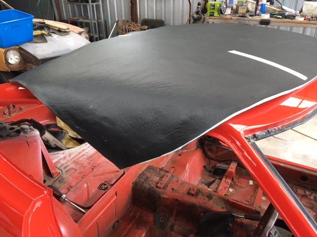

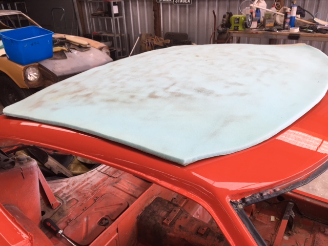

Mark B Posted April 24, 2017 Posted April 24, 2017 That would be me !! I did mine with a vinyl I got from the local trim shop, from memory I used 10mm foam backing . Quote
aircobra Posted April 24, 2017 Author Posted April 24, 2017 and it worked ok? it look like the textured material they use for seat. what the trimmer explained to me is that it comes with or with the fabric at the back. if you flip over the seat vynil, you will see the weaving at the back what type is the foam? open cell/closed cell, density, etc? Quote
Mark B Posted April 24, 2017 Posted April 24, 2017 The vinyl does have a weaved material on the back, so I guess it probably is the same vinyl you would use on a seat. The foam was just what he had in stock , don't know what type density etc, it was just close enough to the thickness I wanted, so I just used it !! does seem to be relatively soft, so not a high density I am thinking. I also used the vinyl on the interior cover that goes on the inside of the tailgate, and it looked good there as well. Quote
aircobra Posted April 24, 2017 Author Posted April 24, 2017 how thick is the foam? did you use the same material for inside roof pillar? Quote
Mark B Posted April 24, 2017 Posted April 24, 2017 10 mm thick, I used it everywhere because I couldn't get any 6mm for the winscreen pillars !! Quote

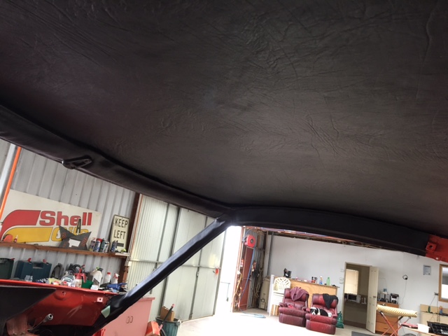

aircobra Posted April 25, 2017 Author Posted April 25, 2017 for the pillar vynil, is it meant to wrap around the panel join, with the rubber seal going over the top? or do i jut cut it short? http://s536.photobucket.com/user/gmac708/media/240Z/2012-08-15184436.jpg.html can;t tell from this photo Quote
Retro Z Posted April 25, 2017 Posted April 25, 2017 Wrap around the panel join in both pillars and windscreen/roof. Rubber seals then go over. The roof frame section then has a rubber pinch trim that goes around the circumference and retains the vinyl. Quote
aircobra Posted April 25, 2017 Author Posted April 25, 2017 do the strut tops have a cardboard template or is the vynil just stretched tight? http://playtoysclassiccars.com/wp-content/uploads/2012/02/5895-Interior-Hatch.jpg i had to remake the cardboard around the strut props Quote
Retro Z Posted April 25, 2017 Posted April 25, 2017 Cardboard triangle that fills in the void of the strut tower and diagonal beam. Vinyl then goes over the top. Quote
