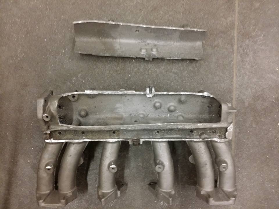

dat2kman Posted April 20, 2017 Posted April 20, 2017 Slicing and porting, and using the EGR channel, to increase plenum volume. For an old racecar, that has to use stock intake,,,, Quote
