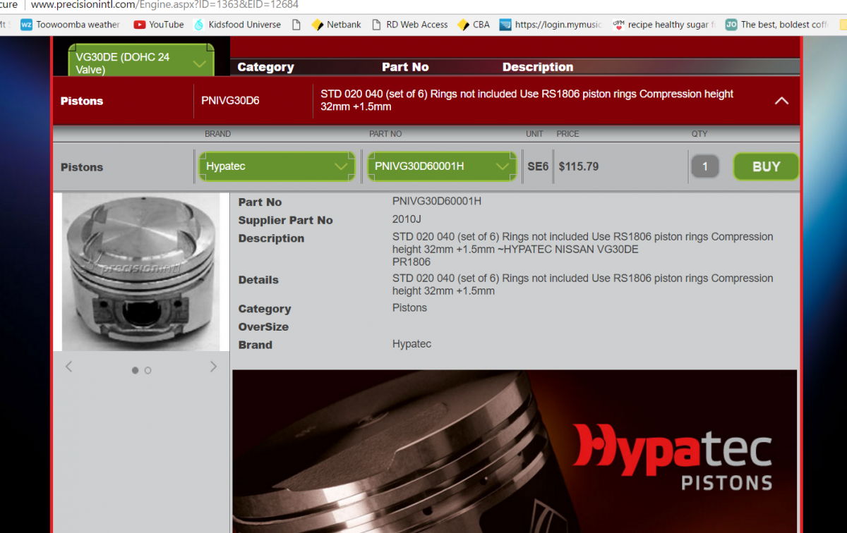

When it comes to comp height I use precision international's website.  9 times out of 10 they have comp height, nice picture etc. AND you can search by engine  ;)
If I have the motor correct, 32mm +1.5mm dome.  Considering the flycut valves there'd be some meat in the top.

Neuby has it right at 32mm compression height but also the gudgen pin is 22mm not a big deal but the compression height is compared to 38.1mm standard.
VW Pistons are a easy fit, just have to have a engine shop bore out the small end of your rod 1mm and then turn off 0.9mm and you have standard compression height or more or less if you want to play with compression.
