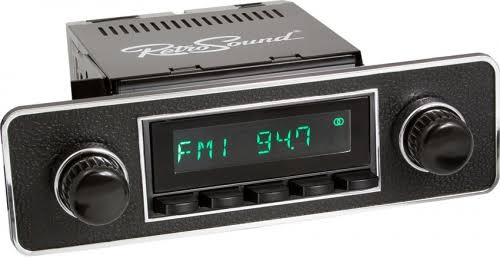

Moderators PB260Z Posted March 2, 2017 Moderators Posted March 2, 2017 Hi For all things Original Radio Gav is your man. If you want an older looking unit but with latesst internals have a look at Retrosound http://www.retrosoundusa.com.au/index.php?l=product_detail&p=299 Quote

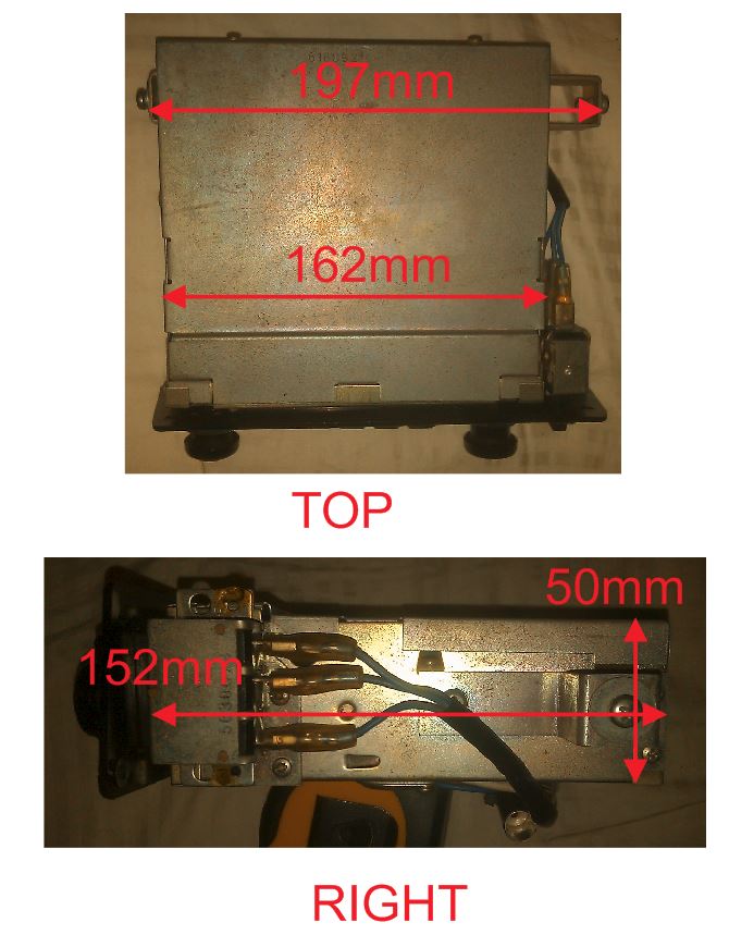

aircobra Posted March 2, 2017 Author Posted March 2, 2017 i realise they are pricey, so just need the overall dimensions of the box sot hat i can work out which unit will fitcould you r could you run a ruler over one pls? Quote
GongZ Posted March 3, 2017 Posted March 3, 2017 (edited) Here are my measurements of an Hitachi TM-1018ZB. They do not include a few screw heads that project about 3mm. Modern radios/stereos/head units are either single DIN or double DIN (double-height); "The measurement of a standard DIN slot is 2-1/8” (50mm) height by 7-1/8” (180mm) width." Therefore any single DIN unit should fit. Edited March 3, 2017 by GongZ Quote

aircobra Posted March 4, 2017 Author Posted March 4, 2017 how does it actually mount? i can see the screwas at the back. is it supported by just the face plate at the front? Quote
GongZ Posted March 4, 2017 Posted March 4, 2017 how does it actually mount? i can see the screws at the back. is it supported by just the face plate at the front? Yes - the radio is fixed to the face plate by the nuts on the control shafts, and the face plate is fixed to the dash with 4 visible screws. Quote
Moderators PB260Z Posted March 5, 2017 Moderators Posted March 5, 2017 Yes - the radio is fixed to the face plate by the nuts on the control shafts, and the face plate is fixed to the dash with 4 visible screws.It is good practice to add a support or bracket on the back of the unit as well.Well that is what I do. Quote
GongZ Posted March 5, 2017 Posted March 5, 2017 It is good practice to add a support or bracket on the back of the unit as well. Well that is what I do. I was responding to how the original radio is fitted - i.e. it also has two screws on the sides as shown in the 'TOP' view photo above. I agree that radios/head units do need additional support, rather than being simply cantilevered from the face plate Quote
