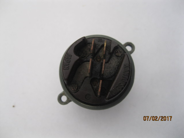

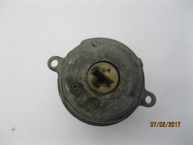

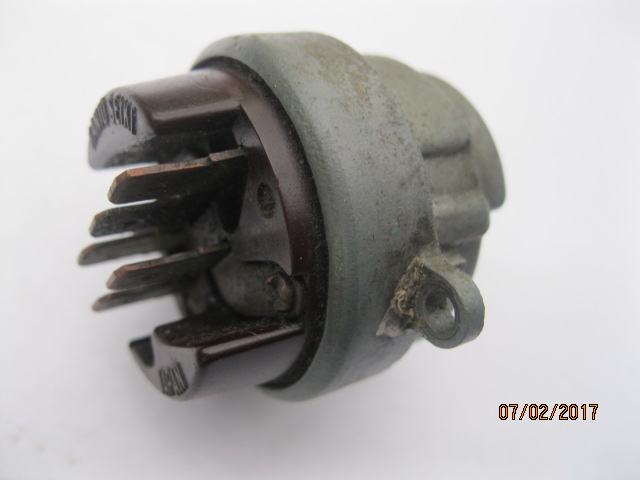

zeds4ever Posted February 7, 2017 Posted February 7, 2017 Can anyone advise me if these are available new in Australia or if someone knows where to have them repaired perhaps . It fits onto the back of the ignition key section . Regards :Alan. Quote

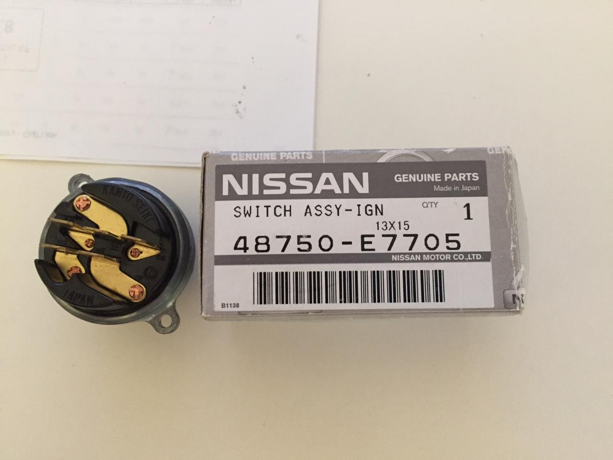

PeterH Posted February 7, 2017 Posted February 7, 2017 (edited) Hi Alan I bought a new switch from my Nissan dealer...genuine part but it was about $100. Another option is this non genuine lock but the switch will not work when fitted to the back of your original lock. http://www.ebay.com.au/itm/IGNITION-SWITCH-STARTER-KEYS-SET-DATSUN-PIC-UP-620-FAIRLADY-240Z-260Z-280Z-/161086341886?hash=item25817e82fe:g:-1IAAOSwZ8ZW7oe9 Regards Peter Edited February 7, 2017 by PeterH Quote
Moderators PB260Z Posted February 7, 2017 Moderators Posted February 7, 2017 (edited) Hi Alan I bought a new switch from my Nissan dealer...genuine part but it was about $100. Regards Peter Hi Wow, I wouldn't have thought you would be able to get them anymore. Guessing it must fit some later model vehicles as well, At $100 that is pretty good buying for a genuine switch. Some time back I tried my local dealer he had zero interest in even looking up parts let alone actually selling them I ended up fitting a complete barrel and switch assy I got off the internet. Cheers PB Edited February 7, 2017 by PB260Z Quote
PeterH Posted February 8, 2017 Posted February 8, 2017 (edited) Hi Alan I bought a new switch from my Nissan dealer...genuine part but it was about $100. Another option is this non genuine lock but the switch will not work when fitted to the back of your original lock. Regards Peter Correction..... I just pulled both locks apart and found that the tab, coming out of the key barrel of the aftermarket one was not aligned correctly and that put the position of the electrical switch out. When I bent that and re-positioned the switch they all work fine on both key locks...sorry about the misleading comment must be my age...or something... Edited February 8, 2017 by PeterH Quote
