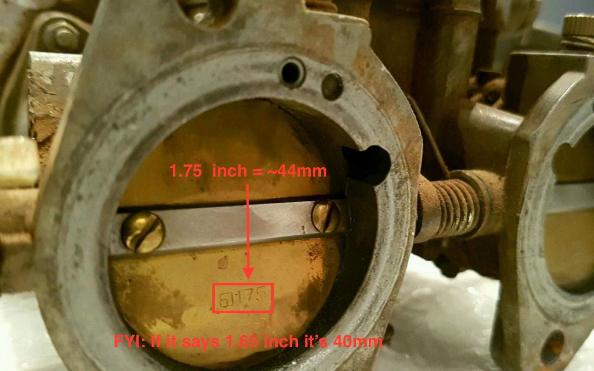

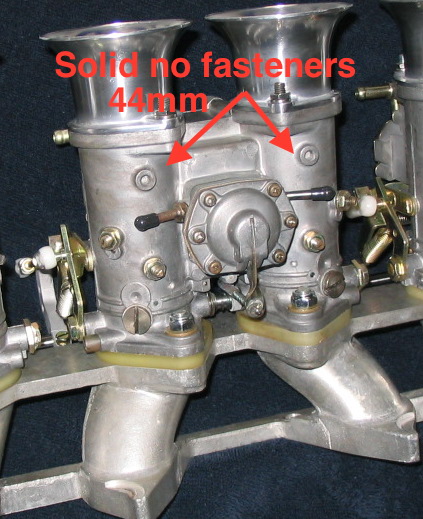

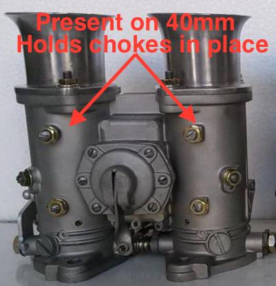

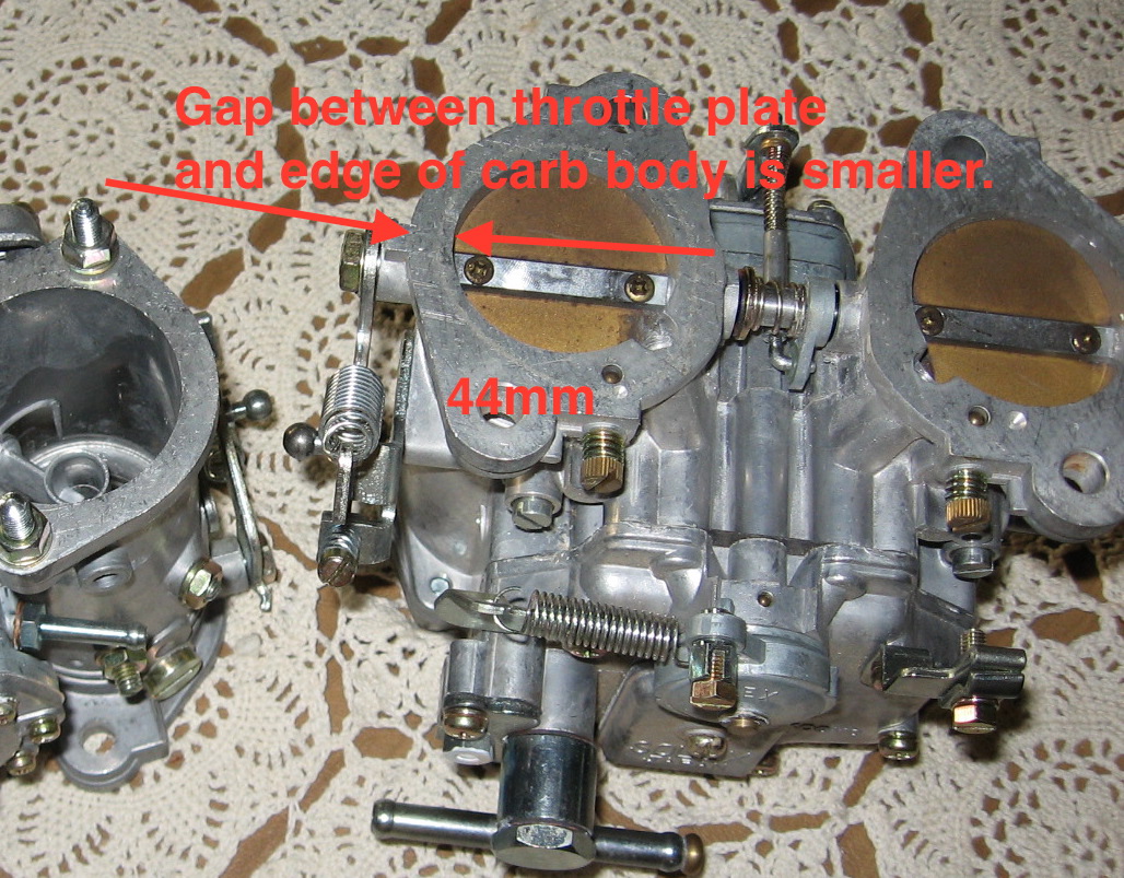

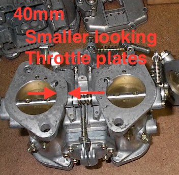

Administrators gav240z Posted June 23, 2017 Author Administrators Posted June 23, 2017 So just thought I'd share some tips on how to identify a 40mm carb vs 44mm carb. 1. 40mm carbs often have an extra retaining fastener on the bottom (front of the intake portion). Where as 44's are usually blank. 2. Just by looking at the throttle plates you can often tell what size they are. 3. Ideally the seller shows a photo of the throttle plate stamping, which will read 1.75inch (44mm) or 1.65inch (40mm). I tried to find a reference photos for 50's but couldn't see 1. Of course carbs have been messed around with over the years, taper bore etc.. so use this post as a guide but not the gospel. This is just what I've picked up hunting down carbs on various classified sites over the last year or so.. Ponyo240z 1 Quote

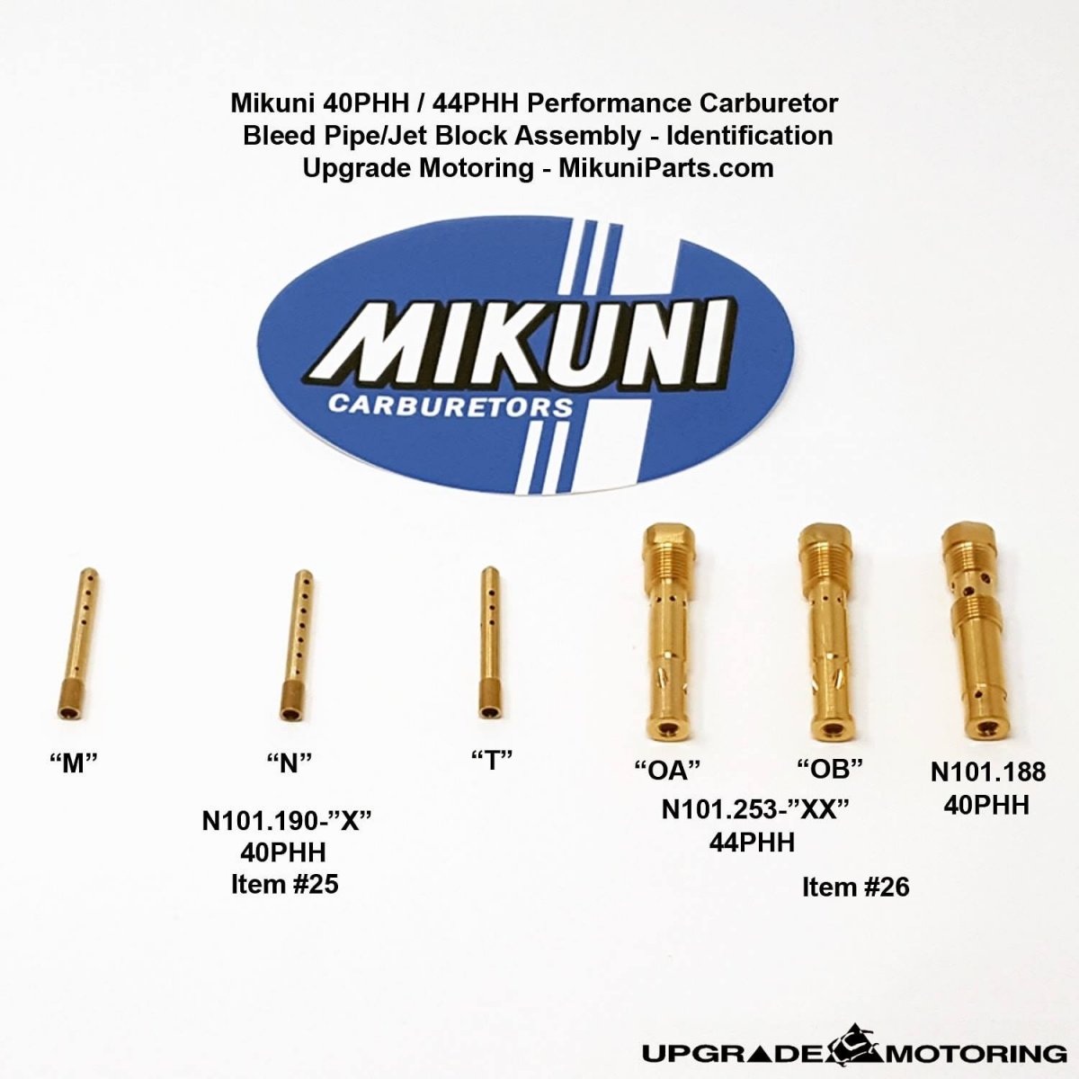

Administrators gav240z Posted February 12, 2018 Author Administrators Posted February 12, 2018 Useful for understanding the anatomy of a Mikuni/Solex PHH carb. cracker and Ponyo240z 2 Quote
