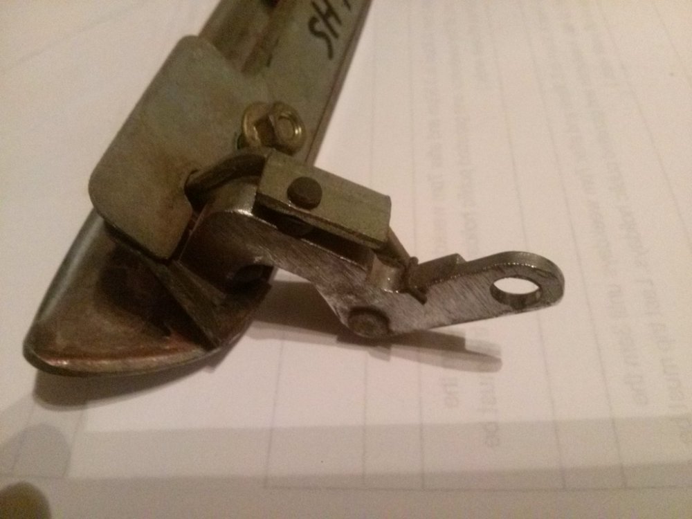

The door handle castings are symmetrical however the metal mounts with return springs and stops are left and right handed.
If you remove the pivot pins it would be possible to swap the handles over.
You would then have to remake the pivot pins.
Here's a photo showing the pivot pin and return stop. These are LH and RH'd.
