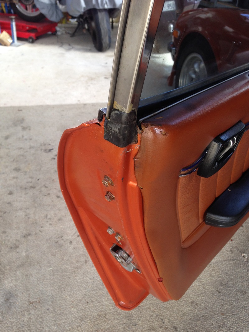

Mark B Posted August 24, 2016 Posted August 24, 2016 Fitting the seal/rubber kit to the 260Z Resto I am doing, and I have these two little seals which I think go up around the top of the side window ?? I am no dope ( but I feel like one ) !!, I have turned this seal around every which way, but can't seem to see how it fits. Can someone please take a pic of this seal fiited so I can fit mine !! assuming of course I am trying to fit it in the right place !! Regards Mark B Quote
gilltech Posted August 24, 2016 Posted August 24, 2016 (edited) Looks like the one which goes at the top rear corner of the door shell, not the window itself. The window glass in frame slides past it. Edited August 24, 2016 by gilltech Quote
Linton Posted August 24, 2016 Posted August 24, 2016 (edited) I wondered if it went in here Edited August 24, 2016 by Linton Quote
gilltech Posted August 24, 2016 Posted August 24, 2016 Yes that's what I think it's for. Not normally included in a typical weatherstripping kit. Must get a pair of those myself, for future resto. Quote
Mark B Posted August 24, 2016 Author Posted August 24, 2016 Yep, you are right !! that's where it goes, well as I said at the beginning of the post, " I am no dope, but feeling like one ", yep I AM one !!! should have seen where it goes myself !! Thanks for the help !! Regards MB Quote
