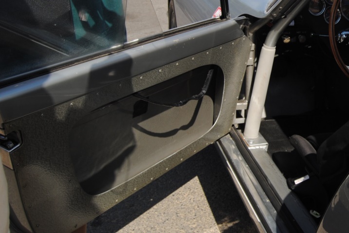

gilltech Posted August 19, 2016 Posted August 19, 2016 (edited) Couldn't you just make them from tempered hardboard, using the Zed card to provide the right outline? Then wrap them in vinyl. The GTOs were race cars so their interiors were basic functional & the door panels plain flat cards. Edited August 19, 2016 by gilltech Quote

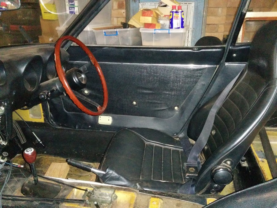

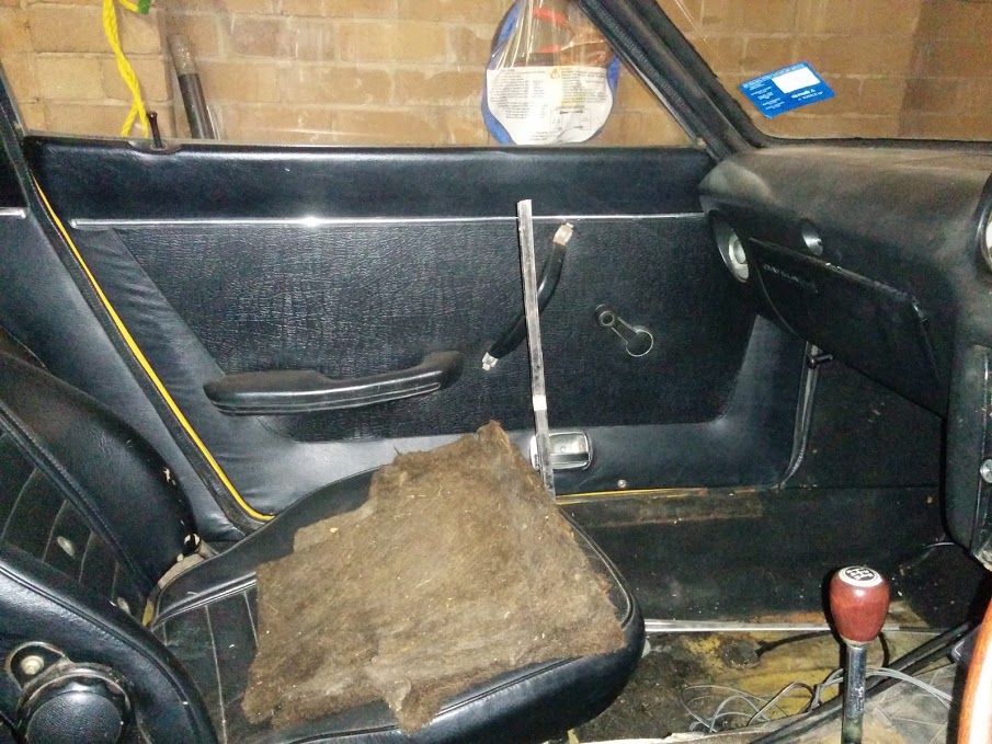

Administrators gav240z Posted August 26, 2016 Administrators Posted August 26, 2016 Photos attached, not sure how I feel about the LH side being cut up. It's a good trim and I kind of want to keep it for my 72 (it still has the Chrome strip). I was going to try Chrome Tape to repair driver side in the 72. You can see the lower left hand corner of the driver side is stuffed. The masonite backing is broken in that corner, but otherwise they were in good shape for age. Quote

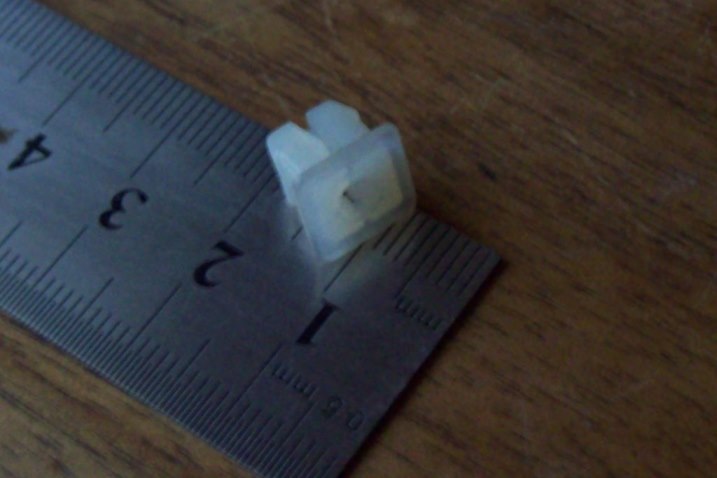

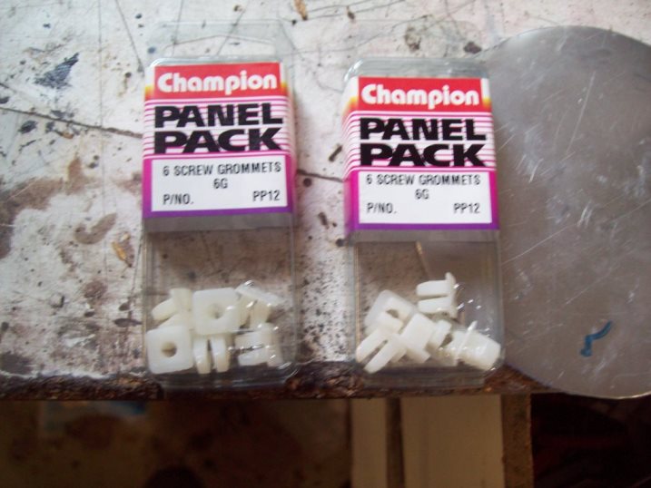

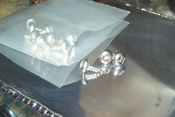

PeterAllen Posted August 26, 2016 Posted August 26, 2016 (edited) Yes... but I want the 'hook' profile at the top to hold in place ... There is quite a range of fasteners you should be able to adapt in lieu of the 'hook', which would allow you to make up your own cards. I've used 'screw grommets' quite a bit on my build - Supercheap have them. Just drill a hole, size it out with a square file (Bunnings) and insert the grommet. I've used stainless, dome-head self-tapers to secure the panel but again there is a huge range to select from. You can leave the top inner edge (70mm or so) uncovered by the card. Edited August 26, 2016 by PeterAllen Quote
