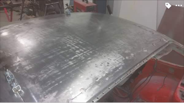

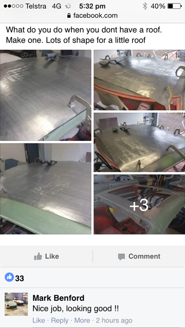

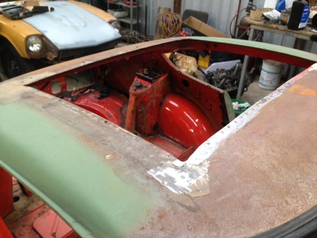

Mark B Posted May 27, 2016 Posted May 27, 2016 Can't wait to check it out mate! It seems so hard to duplicate an original shape roof. Here are a couple of pics, one of what we started with, had a wind back Webasto style vinyl roof, and the other is where it is up to at the moment, hopefully be finished this week !! gav240z 1 Quote
Administrators gav240z Posted May 28, 2016 Administrators Posted May 28, 2016 Looks good, who is helping you make the roof? It is a deceptively difficult shape to reproduce. Quote

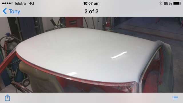

Mark B Posted May 28, 2016 Posted May 28, 2016 Looks good, who is helping you make the roof? It is a deceptively difficult shape to reproduce. I don't have the skills to tackle making a roof skin !! I don't mind doing smaller repairs, and less obvious ones like sill panels etc, and in fact if I could have gotten hold of a roof skin or complete roof I would have had a go at fitting it !! But making a panel which is the first thing that people look at is beyond me !! Its being done by a well know guy in the hotrod/custom car circles in Adelaide by the name of Tony Derose, he had time to do it straight away as a fill in job,and as we all know , most of the restoration blokes are booked up for a year or longer in the future. Tony was keen to have a go, and so far it looks pretty good !! Hopefully he finishes it this week and I can go to Adelaide next weekend and pick it up, then I will put a few more pics up of the finished job and see what everyone thinks !! Quote
Administrators gav240z Posted May 28, 2016 Administrators Posted May 28, 2016 Definitely not the easiest panel on a 240z to do, like I say it's deceptively difficult to make given the curvature of it. I saw how much work was involved in replicating the door on an old hot rod at my tafe course which had similar changes in curvature and I thought, geez I'm glad I have a turret to replace mine with. Makes life A LOT easier. But I do have to do a couple of minor repairs to it etc.. So making a new panel from new steel is also not such a bad thing. I guess Tony didn't even consider patching the hole? Probably too much chance of distortion and more work than recreating the whole roof on some levels I'd imagine. Quote

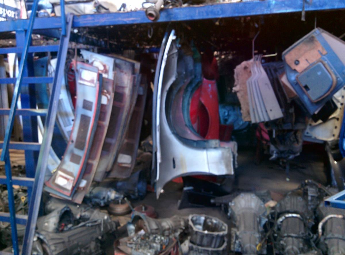

Andrew_L26 Posted May 28, 2016 Posted May 28, 2016 I'd see if you can speak to Lindsay form the Z-Shop in Glen Iris Vic, they are closing down and might be able to help you out. I saw probably 30 entire roof sections in his storage area Didn't get a photo but you can see here fenders hanging up going back about 5m! Quote

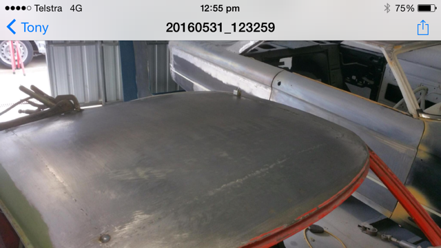

Mark B Posted June 2, 2016 Posted June 2, 2016 Definitely not the easiest panel on a 240z to do, like I say it's deceptively difficult to make given the curvature of it. I saw how much work was involved in replicating the door on an old hot rod at my tafe course which had similar changes in curvature and I thought, geez I'm glad I have a turret to replace mine with. Makes life A LOT easier. But I do have to do a couple of minor repairs to it etc.. So making a new panel from new steel is also not such a bad thing. I guess Tony didn't even consider patching the hole? Probably too much chance of distortion and more work than recreating the whole roof on some levels I'd imagine. Hows good is the quality of this guys work !!! Rolled up a repair patch on the english wheel, grafted it in, all done with metal !! no bog !! I just wish I had the ability to do this , there are some real craftsmen out there, just got to find them. Mark gav240z 1 Quote
Administrators gav240z Posted June 2, 2016 Administrators Posted June 2, 2016 Not easy to weld that up without distortion. Hat tip . In my opinion this kind of skill is under appreciated by many.. As someone who aspires to be this good I can appreciate how good this is. Of course you could develop these skills, it just takes a lot of time and patience and everything goes very slowly. Quote
