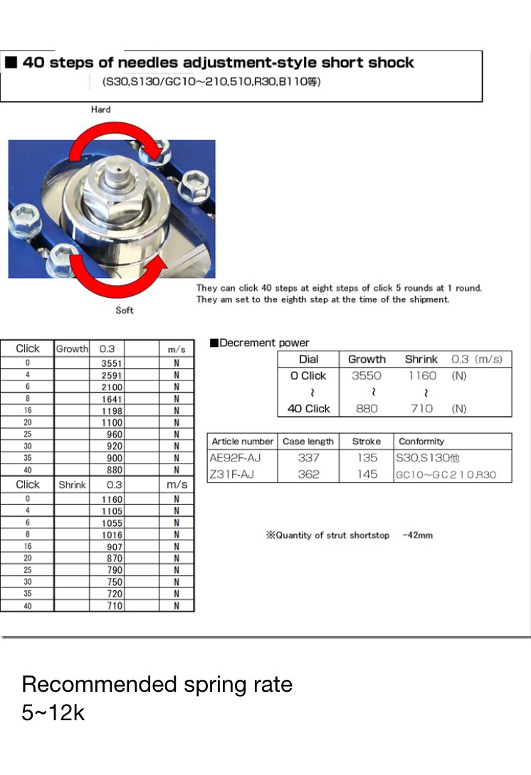

Riceburner Posted April 29, 2016 Posted April 29, 2016 I received some specs for the valving of the Kameari adjustable shocks. Does anyone know how to interpret the figures? Quote
Cozza Posted April 30, 2016 Posted April 30, 2016 (edited) I have never read any shock specs but the way I read it is: Growth is rebound and shrink is bump. Setting 0 is hardest and 40 is softest (which seems a little backward) The measurement is force required in Newtons to move the shock 0.3m in 1 second. So 3551N for growth setting 0 and 880N for growth setting 40. Keep in mind that 1 kg is approx 10 Newton. Edited for clarity. Thanks Gongz So for growth setting 0 you would have to apply 88kg's to stretch the shock 300mm in 1 second. Complete guess though. Edited May 1, 2016 by Cozza Quote

Riceburner Posted May 3, 2016 Author Posted May 3, 2016 With all the other parts I've gone direct through Mori san at Kameari, I guess it'll come down to who's priced best. I found these on ZCCJDM and Brian was good enough to supply that spec sheet. I want to compare shock sizes and specs with a few different options first. I can PM you if you when I get more info. Quote

Riceburner Posted May 5, 2016 Author Posted May 5, 2016 (edited) I find the spec sheet a little hard to understand but the way I read it was that the shocks had only 10 steps of adjustment? I'm not looking to spend 1000's on shocks or having them re-valved, Ideally I'd like something with some adjustment that will allow me to tinker and possibly cope with potential spring rate changes. Specified spring range is 5-12kg, surely they'd have to be pretty decent to be able to control those rates? I've purchased a fair bit of kit from Kameari and its all been first class. EDIT: There's these (bilstein 34-050224) from bilstein to suit a Mitsubishi 300gt. It would mean a lot more work fitting 55mm struts in the rear and some machining of spacers etc. I'm not sure what the valving specs are on these. Edited May 5, 2016 by Gareth. J. Quote

Cozza Posted May 6, 2016 Posted May 6, 2016 I find the spec sheet a little hard to understand but the way I read it was that the shocks had only 10 steps of adjustment? Gareth, check the text bottom right of the image, I think it suggests something along the lines of, 8 settings per rotation and 5 rotations. The specs are definitely not straight forward, I'm still interested to hear other people's take on the info. I find it interesting the rebound (growth) changes between 880 - 3550, where the bump (shrink) is 710 - 1160. The Tokico Illuminas have 5 adjustment settings and I use most of them for driving on different roads and tracks. Softer settings are much better on rough surfaces, both road and track. With my limited experience, I find my car feels better on the tighter tracks with harder settings and longer tracks with medium settings. Quote
Cozza Posted May 6, 2016 Posted May 6, 2016 I just read that link Jason posted and noticed a couple things that might be relevant to the specs above. "you need as a minimum plots of the forces at slower speeds, around the 3 in/sec peak speed range. Plots of faster speeds are OK, but once you're over about 10 in/sec you're into "big bumps" mode and you're probably just digressing the hell out of the forces anyway." The specs above are for 300mm/second which is close to 12"/second, a fair bit above his suggested speeds of interest. Also, "Amazingly, save those brands mentioned in that earlier list, this was a non-stop parade of horror, including, but not limited to: Adjusters that had more crosstalk effect than they had primary effect (ie, a rebound adjuster where 1 click made a 10% change in rebound and a 30% change in compression); Adjusters that were nonlinear and exponential;" The specs above are no where near linear and vary massively between the 2 modes. Not trying to diss the Kameari shocks just picking up on some points that Jason's link commented on. Quote
