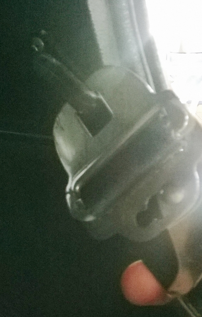

gilltech Posted April 2, 2016 Posted April 2, 2016 Thanks PB260Z, I'll give it a go once it's daylight. Meantime, the hook is 50mm long top to bottom of curve, with a 35mm upwards return, & is 12mm wide. The 35mm portion has a dogleg halfway up - bending outwards - to make the hook more accessible. My '74 was NZ-new, I don't know if your Aus cars had the same 3-piece fixed seatbelts or not? The ADRs were different to NZ's & you guys got your own specific Aus-market Zeds from what people on this forum say. Quote
gilltech Posted April 3, 2016 Posted April 3, 2016 See attached - not a good image as it's a black interior in a well shaded location, but hopefully clear enough. I've swung the seatbelt forward, & you can see the line of the door jamb right behind. aj_ 1 Quote
GongZ Posted April 3, 2016 Posted April 3, 2016 It looks the same as the 240Z hooks; US$25 a pair plus shippig http://www.new-datsun-parts.com/datsun-240Z-parts-interior2.html Zeddsaver also sells them for US$40 a set but lists them as 240Z - 280Z seatbelt hooks http://www.zeddsaver.com/products/240z-280z-interior-seatbelt-hooks aj_ 1 Quote
aj_ Posted April 3, 2016 Author Posted April 3, 2016 See attached - not a good image as it's a black interior in a well shaded location, but hopefully clear enough. I've swung the seatbelt forward, & you can see the line of the door jamb right behind. Too easy, thanks. Quote
