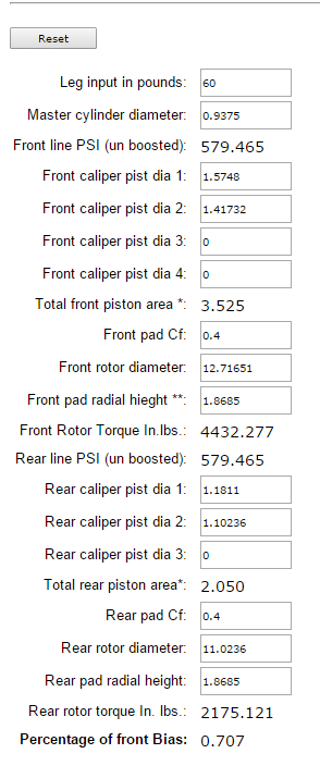

d3c0y Posted January 11, 2016 Author Posted January 11, 2016 Thanks for the answers guys. Maybe i need to go deeper into what I am doing so we are on the same page. Basically I am building an entirely new brake setup consisting of: Porsche Boxster 986 4 piston monoblock calipers all round (They have different size calipers front caliper pistons - 40/36mm - rear caliper pistons - 30mm/28mm) 15/16th master cylinder (which is what the Porsche has) Custom braided lines (required to fit the calipers anyway) Obviously custom brackets to mount calipers 323mm 2 piece DBA front rotors 26mm thick (from an Rx-8 sport package - 47mm rotor offset - 8% increase in size) 260z hubs Handbrake caliper setup Willwood Line Pressure Reduction valve At this stage, I was thinking of going S13 Silvia front rotors for the rear (easy to get in 2 piece 280mmx22mm) or Z31 front rotors. (274mm x 20mm - correct width for the caliper). The Boxster comes factory with: F Disc 298mm x 26mm R Disc 292mm x 20mm From what I have read, a rear engine car will have a more rearward brake bias from the factory than an front engined car. So what I am trying to do is have a more rearward bias than a factory zed to allow for fine tuning but at the same time run the smallest rotor I have to at the back for unsprung weight advantage. Roberto's answer has been helpful for giving me a ball park to base my targets around at 70:30 and probably aim for 65:35 as a minimum. I think the Boxster is pretty close to 50:50 and obviously I need to figure this out too. As Jason has suggested previously I can do this using % increases and decreases from the stock setup, but this becomes hard with drums at the back. The other question i need to answer is will a caliper designed to work with a 292mm rotor work on something as small as 280mm as that might be another limiting factor? Quote

d3c0y Posted January 13, 2016 Author Posted January 13, 2016 More worried about not having enough rearward bias with a 280mm rotor that is my issue here. I don't want to go and make up all this gear and order rotors to go, oh it's too front biased. I'll keep calculating and post up what i am getting, for group thoughts. Quote

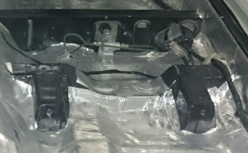

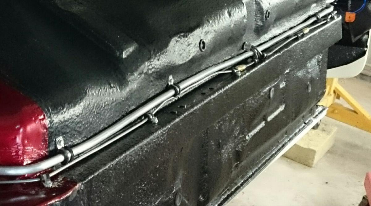

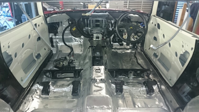

red76z Posted January 13, 2016 Posted January 13, 2016 Just following the line to your back brakes and cut into add a joiner and drill a hole in the floor connect to adjustable proportioning valve in my case a willwood unit then come out of that back through the floor and re conect to brake line with correct joiner.( It is Just a tap) See photos for info just zoom in as I took these during the build about a year ago. Put your valve wherever you are comfortable with. The engineer was happy with this idea. A few rubber grommets in tne floor for the lines to enter/exit and a bit of silicon to seal against the weather. Quote
