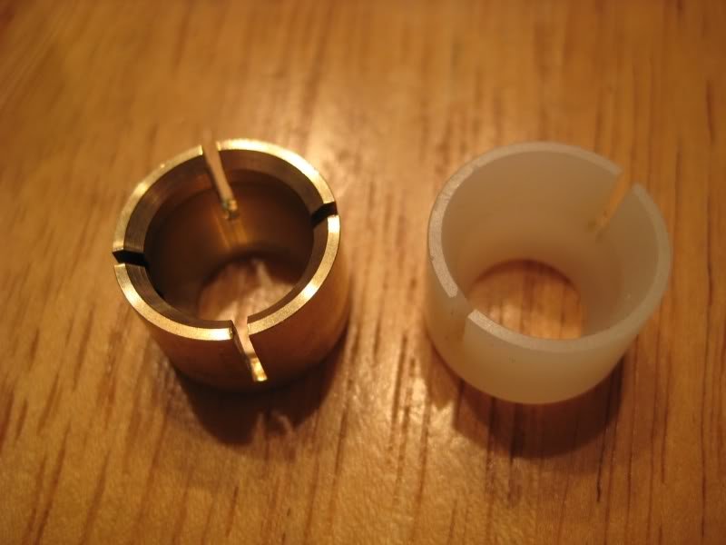

Agno Posted January 5, 2016 Posted January 5, 2016 Just thought I should share my recent discovery, the shifter bushing in my gearbox (FS5W71B aka 260Z gearbox) was cracked and worn out. Instead of going to Nissan to get a new plastic bush I bought a GKTECH brass bush to suit a Silvia. The brass bush will apparently give a better feel in the gearbox and also last longer than another plastic bush, now I just need to machine some new inserts for the roll pin bushes! A quick comparison of plastic vs brass shift bushes is below (borrowed from Google): Cheers Quote

Agno Posted February 3, 2016 Author Posted February 3, 2016 Update I took delivery of the brass shifter pin bushes a couple of weeks ago. They are much thicker than the original plastic items. They are advertised as being tighter tolerances than stock but there is literally zero tolerance. As a result the shifter no longer fit inside of the clevis without me turning down the thickness of the face of the bushes by about .4mm on each bush... Even then it was still an extremely tight fit and effort required to change gear is much higher. I bought the ones listed below: http://www.ebay.com.au/itm/221965954665?_trksid=p2060353.m2749.l2649&ssPageName=STRK%3AMEBIDX%3AIT While the shift feel is nice I think it's significantly less hassle (and probably cheaper considering how long they last) to stick with the original style plastic bushes. In saying that everything feels great and now I've spent the time making everything fit I assume they will never have to be changed again! Quote
