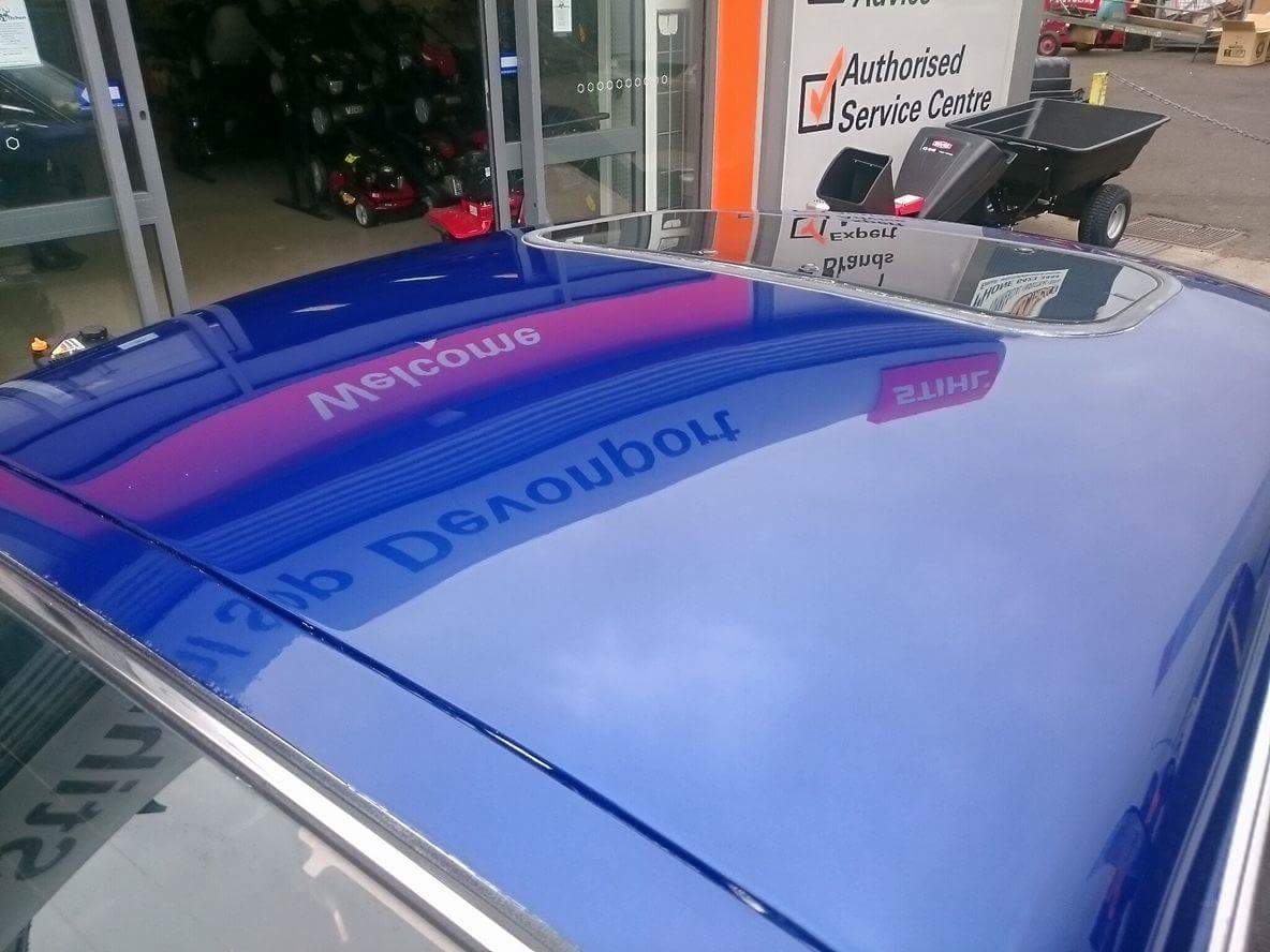

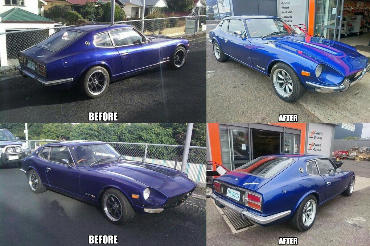

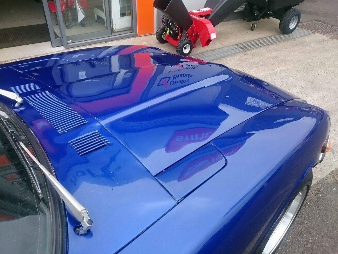

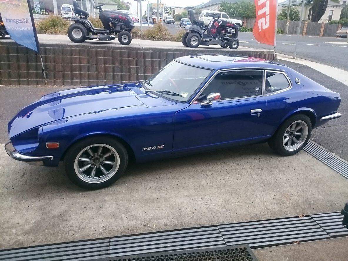

Now we go back to the original post by Tom... They did not put a clearcoat on the car but instead mixed the clear with the final coats of paint...
I had well and truly missed my buffing window by 5 years. I tried a few compounds from Super Cheap and they were not even bringing any swirls out of the surface.
I had to Wet Sand first 1500 grit then 2000 grit on every single panel. Orange Peel Galore and this paint was hard as steel. It only took 4 days to complete the job hand sanding and machine polishing. I highly recommend the 3M Perfect-It system and buffing pads. The results are more than adequate to the untrained eye but could use a little more wet sanding on the side panels.
I must thank a few family and friends for their help on this one, especially in my absense at work. Jimmy (helping with original engine swap), Perko (helping me swear at the car and the major works), Doug Eastly (assisting with transport odds and ends), Valerie Wells (helping organise everyone), Rhiannon Wells (for choosing the blue one), Troy Eade (installing new plugs), Mark Wells (Tuning Carbs and transport), Discotune (fixing a few odds and ends for registration) Alli Jane Wells (My partner putting up with me swearing about this car)
Going back to the start of this saga "EVERY ZED HAS ITS OWN STORY AND PASSIONATE OWNERS" not only that but brings the passion out in others. Either through memories of their own seeing a zed for the first time or just being mates.

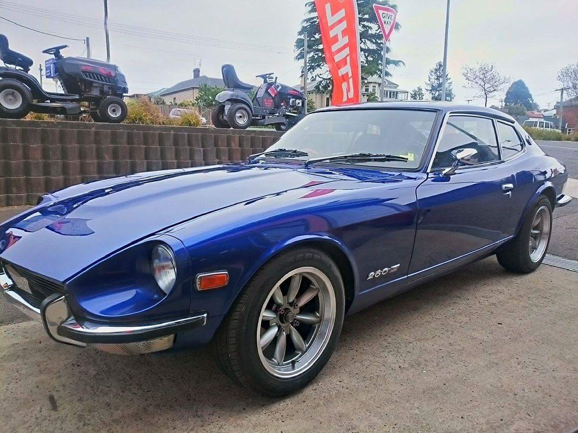

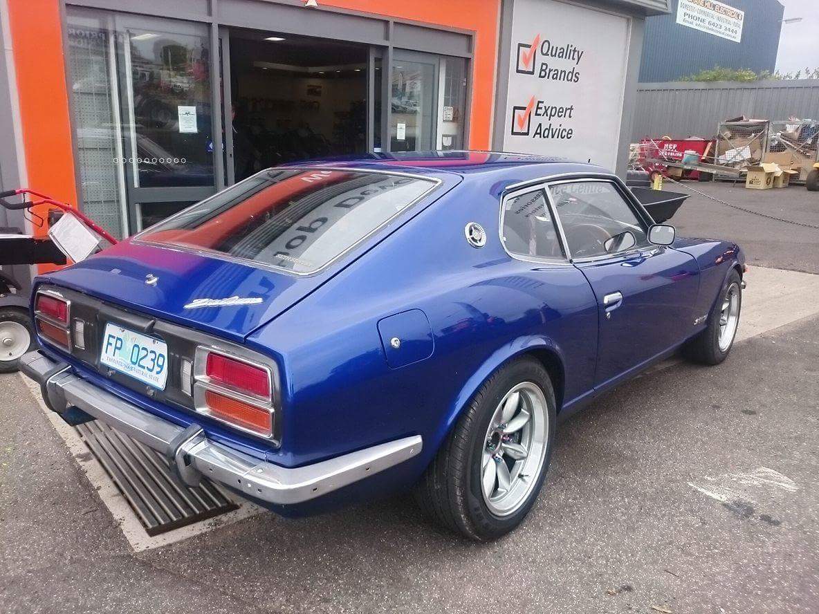

Please see the finished results below, still pending pit pass. I am confident it will make it.

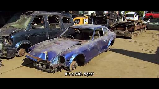

By the way this is a screenshot of the move "Wangan Midnight" Notice how it is a 2+2 when he finds it in a junkyard? Then the rest of the movie it is a 2 seater... They probably could not bring themselves to destroy a 2 seater in the movie either.
post-100594-0-33246200-1447423636_thumb.jpeg Well passed inspection... Next job is to register and drive the 16 year old to her leavers dinner.
The it will be back in the shed for an underbody and under hood spray. Along with powdercoated suspension components.
Apart from when he flips the 240z onto its roof, then it magically becomes some other car. Not sure what exactly.. my best guess is a late 70s mitsubishi lancer coupe.

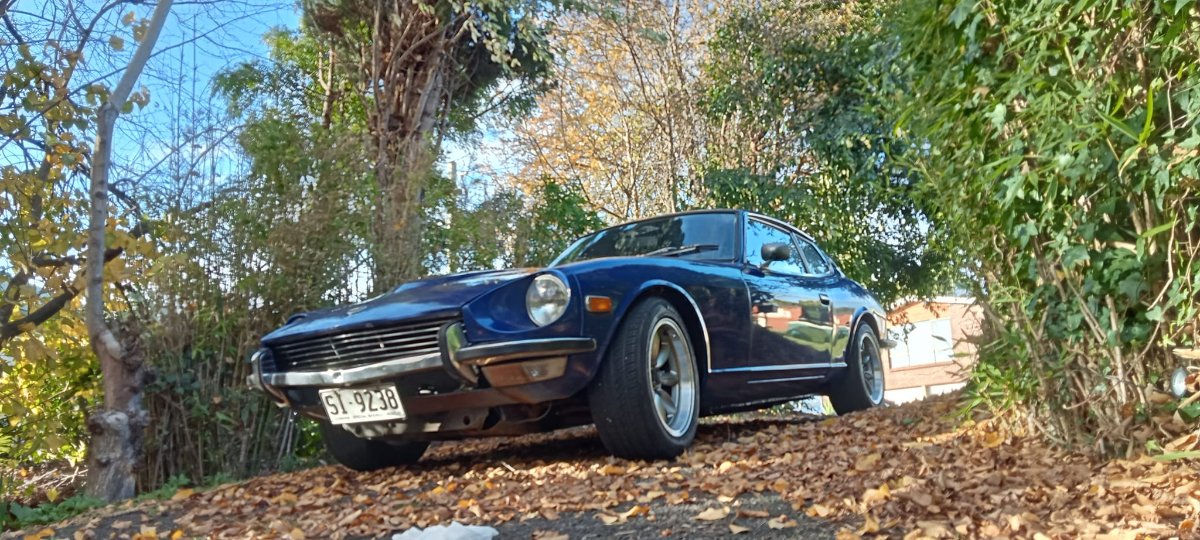

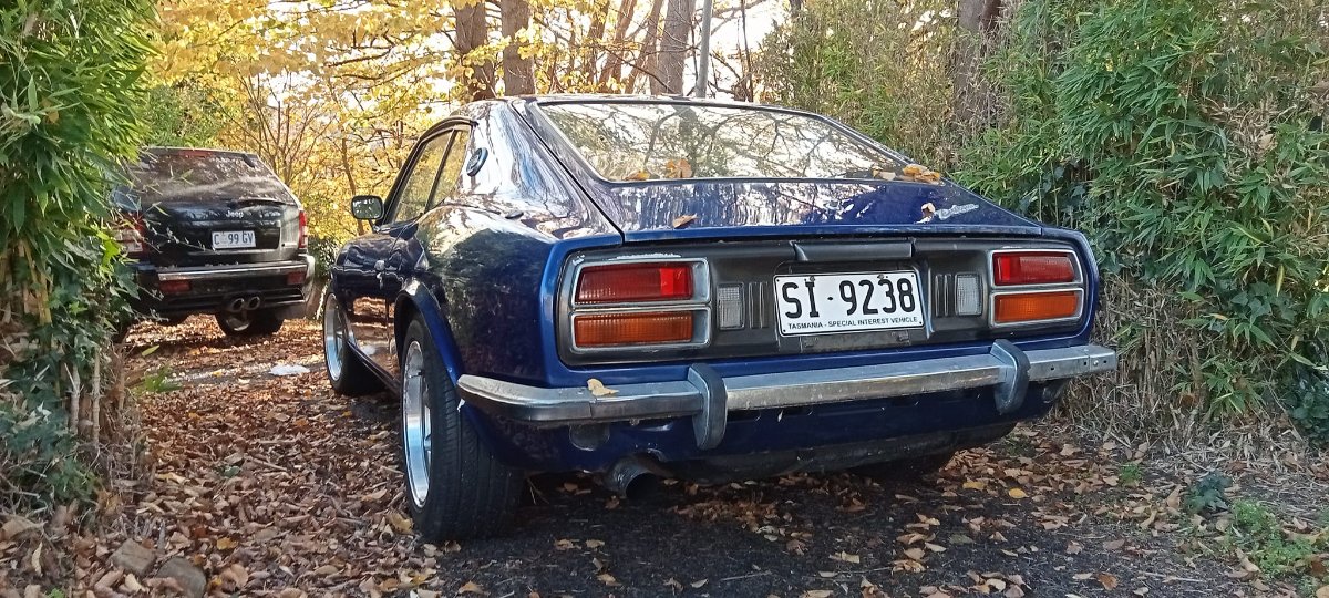

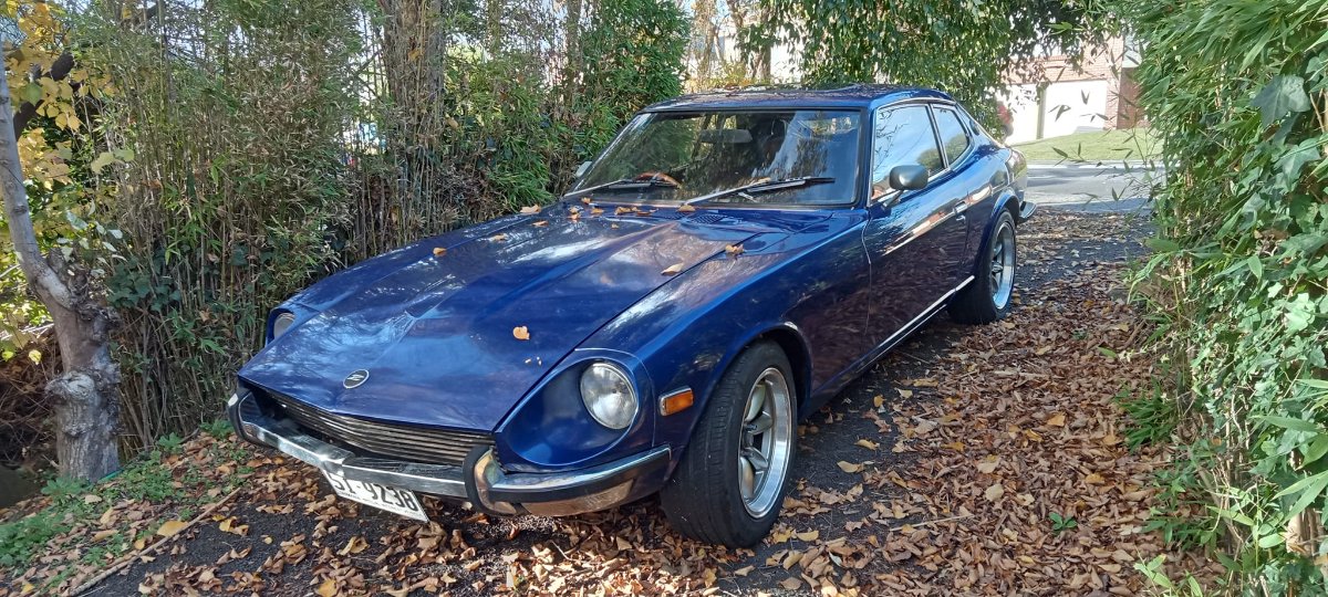

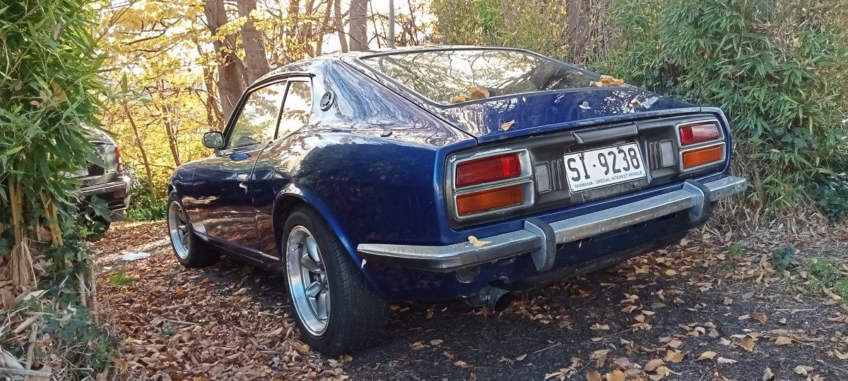

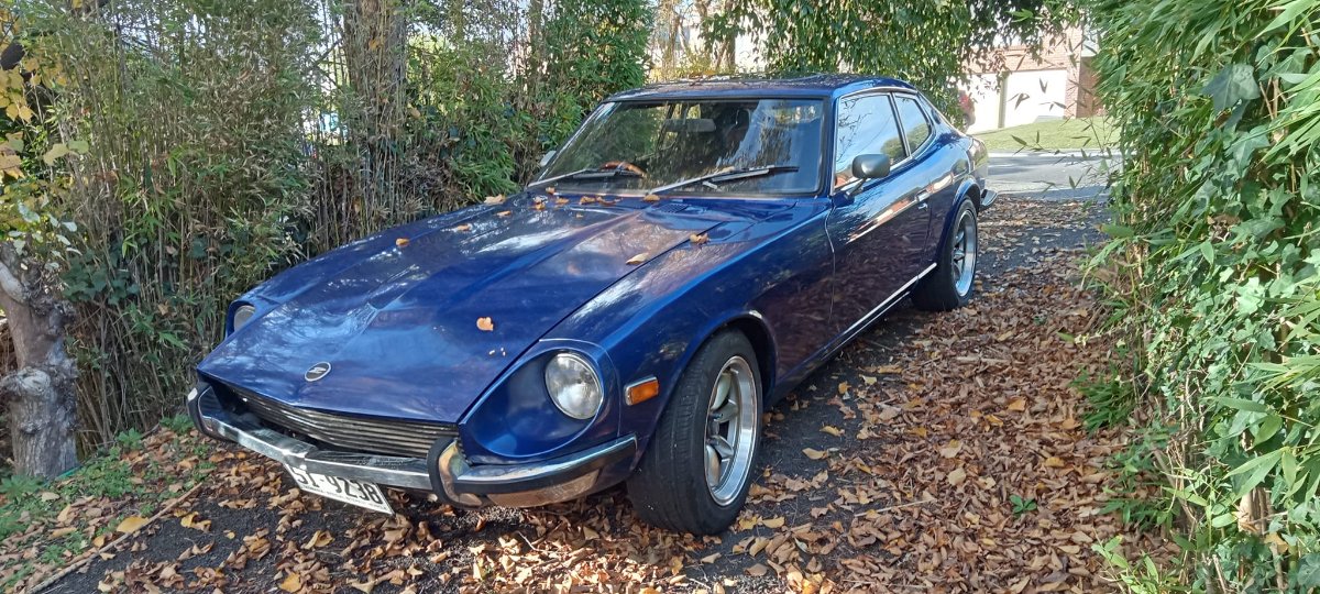

8 Years later and 7 years since it has been started... I shove a new battery in, jump in, turn the key and amazingly it fires straight up, albeit a bit rough.
Some contact cleaner in the dizzy, and fresh oil.
Off for some paint touch up this week.
