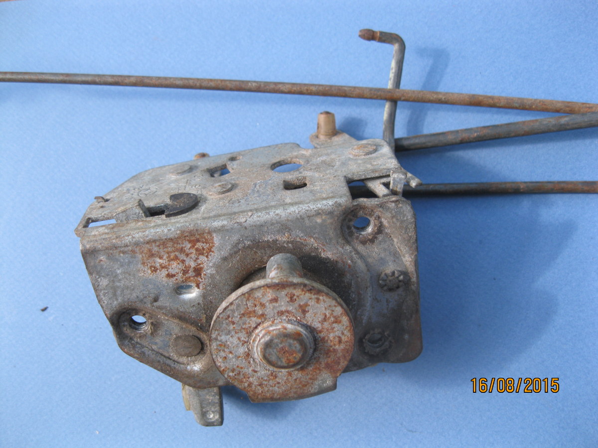

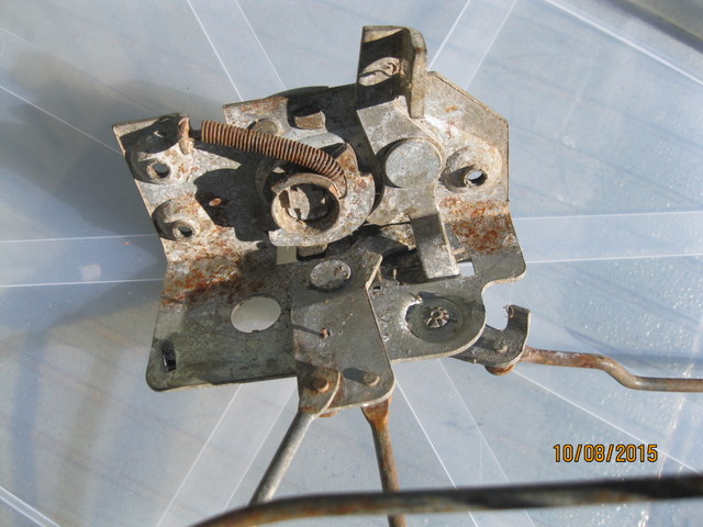

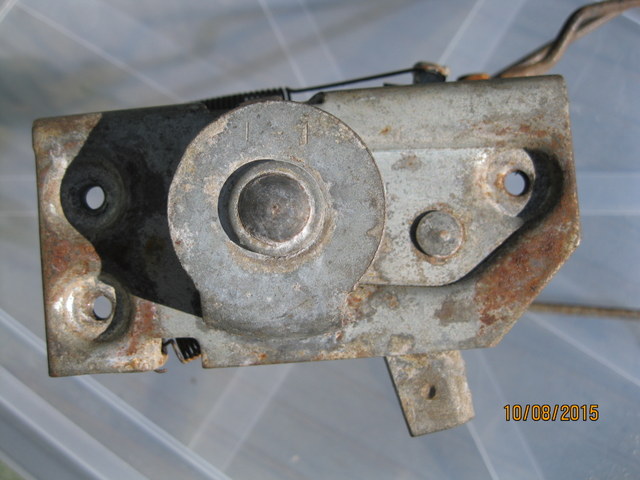

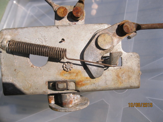

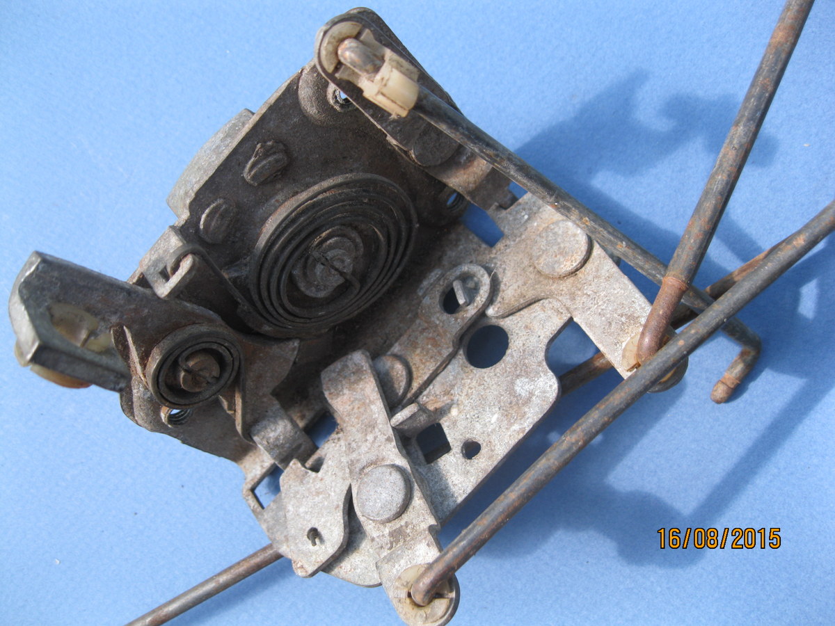

                  Had a closer look at door lock , turns out that it is passenger side. However if lock is the same type as the one in the pics iv'e included
                  you should be able to interchange the springs ,etc as they are interchangeable IE l & R are the same configuration from what I can see.
                                              Regards:Alan.
          G'day mate, don't know if you are still after door lock parts but I found a passenger side unit from
          which I think you can use parts to suit your needs. See pics.
                              Regards:Alan.
