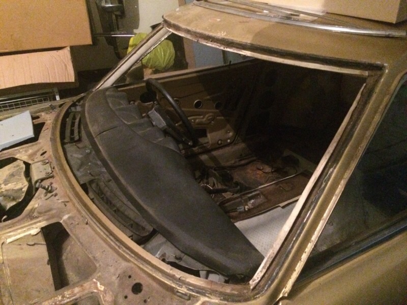

Azman1984 Posted January 28, 2015 Author Posted January 28, 2015 Thanks for all the hints guys, got the screen out today. The seal was quite brittle on the outside due to weathering and took a bit of work to get the chrome trine out. Once they were out putting the bigger cuts in the seal and removing the screen was pretty easy. Quote

Azman1984 Posted January 28, 2015 Author Posted January 28, 2015 So the cutting worked? Hopefully the strips came out intact Cheers John Yes I did thanks John got all the chrome strips out in tact and nice and straight. Quote
