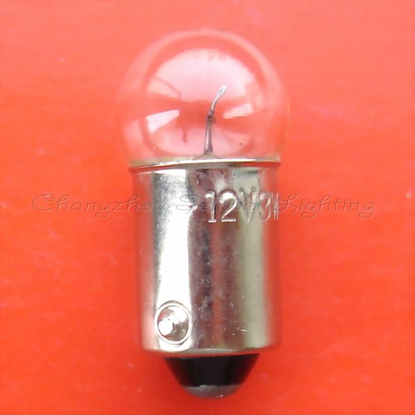

sydney mike Posted December 3, 2014 Posted December 3, 2014 Not sure if the same as 260z but for my glovebox and centre triple gauges it is "12v 3w BA9s" which I got from supercheap. You can find LED alternatives with the same code type on ebay. Quote

Administrators gav240z Posted December 3, 2014 Author Administrators Posted December 3, 2014 Also how bright are they compared to the stock globes? Quote
lightmaster240z Posted December 3, 2014 Posted December 3, 2014 Yes and no. yes they are brighter than the standad one and no not all will work with a dimmer. Some will strobe or flicker. But for ten dollars it was worth the gamble and it payed off his time. Quote
