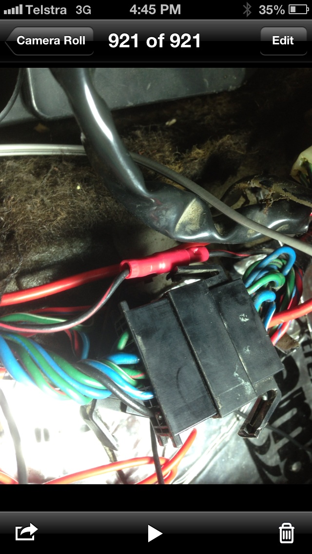

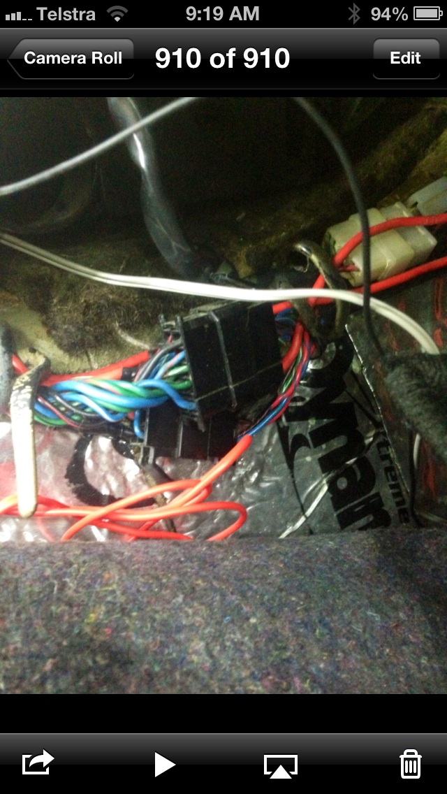

Mr260z Posted July 12, 2014 Author Posted July 12, 2014 Are these the connectors you mean Benny? Quote
Mr260z Posted July 14, 2014 Author Posted July 14, 2014 Well thanks Benny, indicators all fixed and was all due to the wire in photo that I now have the red connector on. Only took around 12 hours of searching till Benny pointed me in the right direction. Seeing as you know the car Benny, do you know if the temperature gauge ever worked? Quote
benny Posted July 14, 2014 Posted July 14, 2014 good to hear... it had a leaking heater core so it was just flooding and corroding those connectors. Cant say on the temp sender however you should be able to track the wire back/ test it from the cabin to sensor for continuity. Or just pullover if your steamin' Quote
