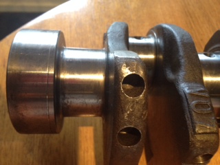

Also, is this wear mark from the rear main seal an issue? I think my current L28 was the same when I rebuilt it.

That wear on the rear is quite normal and would be taken care of at time of rebuild / machining. It's caused by the rear main seal.
