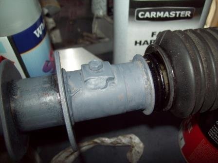

Getting the steering rack ready and I noticed the bolt shown in the photo. A quick look on Google images shows a grease nipple in lieu of the bolt in some images. What should be there?

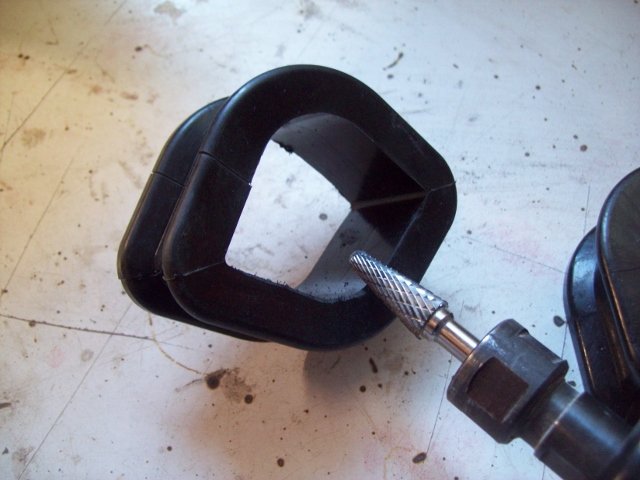

Also reworked the bushing (260Z I think) to mate with the contour of the rack I have (240Z?). Note, the photo only shows the process - a fair bit of material needed to be removed.
IIRC it is a bolt installed in a place where you can install a nipple, grease up the rack then remove nipple and install bolt again.
With regard to my 260z (can't remember for 240z), definitely a bolt meant to be there, mine has the exact same bolt as yours.
Had similar issues with my rack bushings. 260z rack, think I bought 260z or 280z bushing kit (can't remember), and had to shave about 5mm off of each side for them to squeeze in properly.
